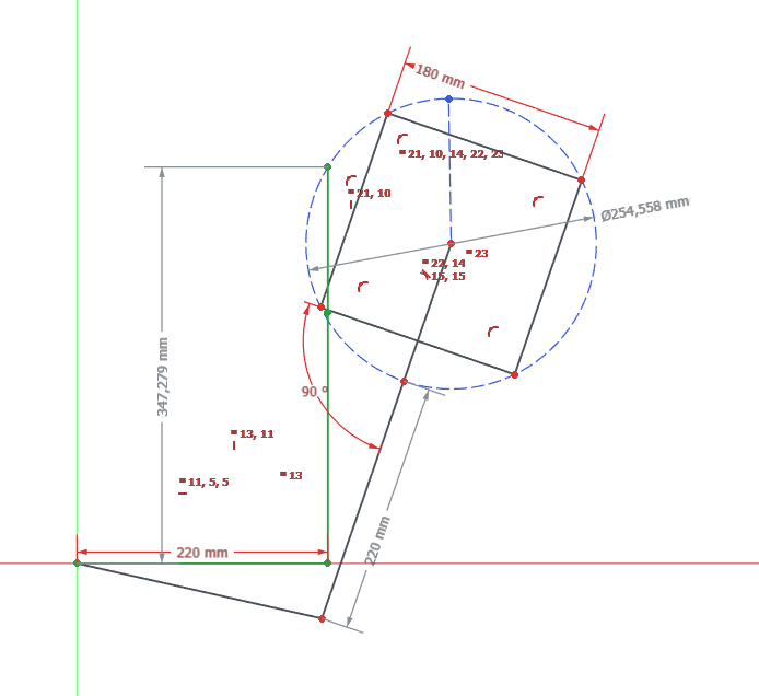

    Hm, these existing concepts all use linear movements. But as the needle is round, orientation is not important. And support of the vertical axis is given by the sewing machine. So I am thinking about two rotating axis like a robot arm holding the frame. Frame shall be 180mmx180mm. This area lies in a circle of diameter 255mm.
    Length of 220mm for each lower and upper arm should be sufficient.
    Movement shall be done with a step motor and a belt drive for each axis.
    Thanks to P2's cordic, conversion of coordinates should be easy?

    There seems to be some misunderstanding here. For embroidery only the position of the stitch is important. Way of movement between stitches have no importance. So if coordinates are converted properly, there should be no "funky pattern". The relative rotation of the needle between two stiches will be small. There are 2 degrees of freedom here: A shoulder joint and an elbow joint. Together they give X+Y. Perhaps this picture is better:
    Green lines give position of needle to shoulder.
    Will it be a "real" embroidery machine? Yes, I hope so. :-) Of course it can do only one colour at a time.... The expensive part is the sewing machine.
    Depending on arm length and gear ratio I hope to chieve 0,2mm resolution. The big gear is to be printed ABS. 240 teeth. Linear axis would give higher resolution.

  • With rotating axes it looks, if I only need to buy very few parts. And I can use the same printed parts twice.
  • The design changed a little bit mainly to get the right hight and no, I was not able to use identical parts twice. Good News: The printed wheels do fit to the timing belt. :-)
    There was a "funny" finding though: I had used a free internet calculator to get the centre distance for a given length 610mm of the belt. When the belt arrived and I tried to mount, the real centre distance was about 160mm instead of calculated 128mm! :s
    So to keep the length of the arm I made a new wheel for the upper arm with 288 teeth instead of 240. I also found a better calculator..... Never trust anything on the net....
    Some effort was put into the bearing units to make them precise. They each use two 8x22x7 608ZZ ball bearings, which you can buy easily because they are used for skaters. The axle is a bolt M8x80. As it's shaft diameter is too small, I used some adhesive tape to increase the diameter. Also the bearing chair has a press fit. There is a sleeve between the bearings on the bolt, so one nut can hold everything together.
    The block on the right side of the picture indicates the sewing bed of the machine, which has a height of 90mm. The circle is the needle position.

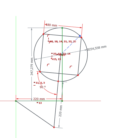

  • Oh oh oh, finish of "things fall into their places".
    I have now begun to do the coordinate transformation. While Freecad can solve this easily, the solution for P2 "is not obvious to me". (To say the least.)
    Given: X=50, Y=75 and the geometry
    Wanted: The two angles Wu=19,13° and Wo=64,23°

    I already had some idea how to use the rules of cosines here. But I then realised, that my original coordinates X Y are also rotating. These give an offset to the wrist.
    Forward calculation with given angles seems simpler.
    Perhaps I will try some 2 dimensional iteration or some sort of interpolation in a 2 dimensional table.
    Edit after some sleep: Well at least the study of https://de.wikipedia.org/wiki/Inverse_Kinematik brought, that it is not a trivial problem. I also think, I have some strategy, perhaps not the most efficient but hopefully doable: I will try iteration using 2 times cordic rotations for the forward calculation.

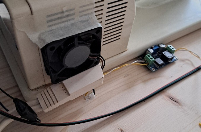

    1. When the yarn is pulled, then an additional yarn break is activated. This is no problem for small movements like normal sewing stitches but it is not good to do large movements, so it is better to start movement before.
    2. The sewing machine has a light bulb lamp. As in my setup the whole machine is controlled by the triac, this light bulb is in parallel to the sewing motor and sees the same voltage. It is very effective as a break-resistor and helps a lot to tame the dynamics of the drive of the sewing machine. - I do not really understand, what happens to the magnetic field, when the triac is off, because the field winding of the motor then is also switched off. In any case the back emv voltage seems still be to be generated. The light bulb will also act as a massive snubber.

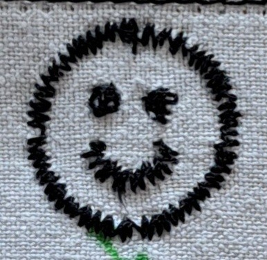

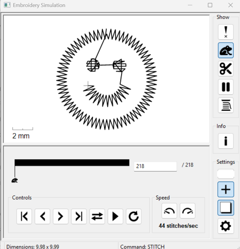

    That is intended to be a smiley... (Well, I never liked these drawing programs. Will have to get better....) But you can draw something with Inkscape and the InkStitch plugin can convert it to embroidery stitches. In this case zigzag.
    The result can be saved in several formats. Among them is GCODE and also HPGL. I always liked HPGL. It is simple and powerful and does only need integers. Resolution here is 0.025 mm. Seems to be fixed.
    There are only 3 commands necessary for the interpreter to unterstand:

    Sometimes imperfection is more fun.... :D
    So the hpgl-interpreter works. It is only 62 lines.
    This is upscaled x2 from the 10x10mm hpgl to 20x20mm, my second trial. I think, the resolution of 1/40 mm is not the reason of all that jitter.
    It would be good to have some direct comparison with a bought embroidery machine.
    Nice thing is, that Inkstitch automatically adds stitches to fasten the yarn. You can just cut the thread. (I don't know the correct translation of "vernähen").
  • Christof Eb.Christof Eb. Posts: 1,506
    edited 2025-10-11 17:25
    Trying to improve resolution: Lowered tolerance for coordinate transformation, increased stepper motor current. Both seemed to help a bit.
    And ordered steppers Nema17 42x46 with 0,9degrees or 400 steps per revolution.
    Half step resolution will then be doubled.
