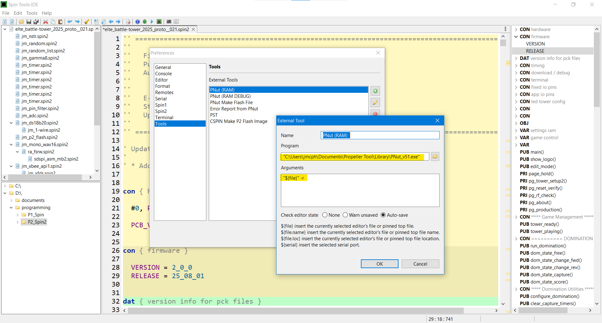

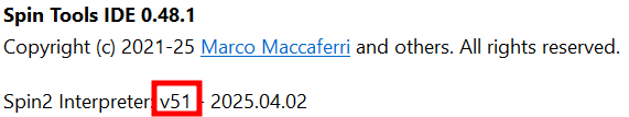

the latest version of Spin-Tools v48 includes Spin2 Interpreter v51, but I need v54 to get to use the recent Structs language feature. is there a way to update underneath it?

  • is there a way to update underneath it?
    In those rare times when the Spin Tools compiler is a bit behind PNut, you can always call PNut from Spin Tools instead of using the internal compiler.
    perfect, thank you!
    The latest Spin Tools release already supports the structs feature and, AFAIK, is on par with PNut. As other pointed out there is no v54 as far as I know.
    Upgrading the interpreter binary is a bit complicated and requires to unpack and repack the spin-tools jar file, however without the corresponding compiler support it is useless.

    @evanh @macca d'oH! a bit of the dyslexia for me. again and again I transposed 45 / 54 in my head.
    putting this bit at the top " {Spin2_v46} " as in the documented sample helped clear my head up
    not sure why, now in the light of day, it all works. but last night, SpinTools kept calling out my STRUCT declaration, which sent me down this road. now, I can't get it to not like it ¯_(ツ)_/¯
