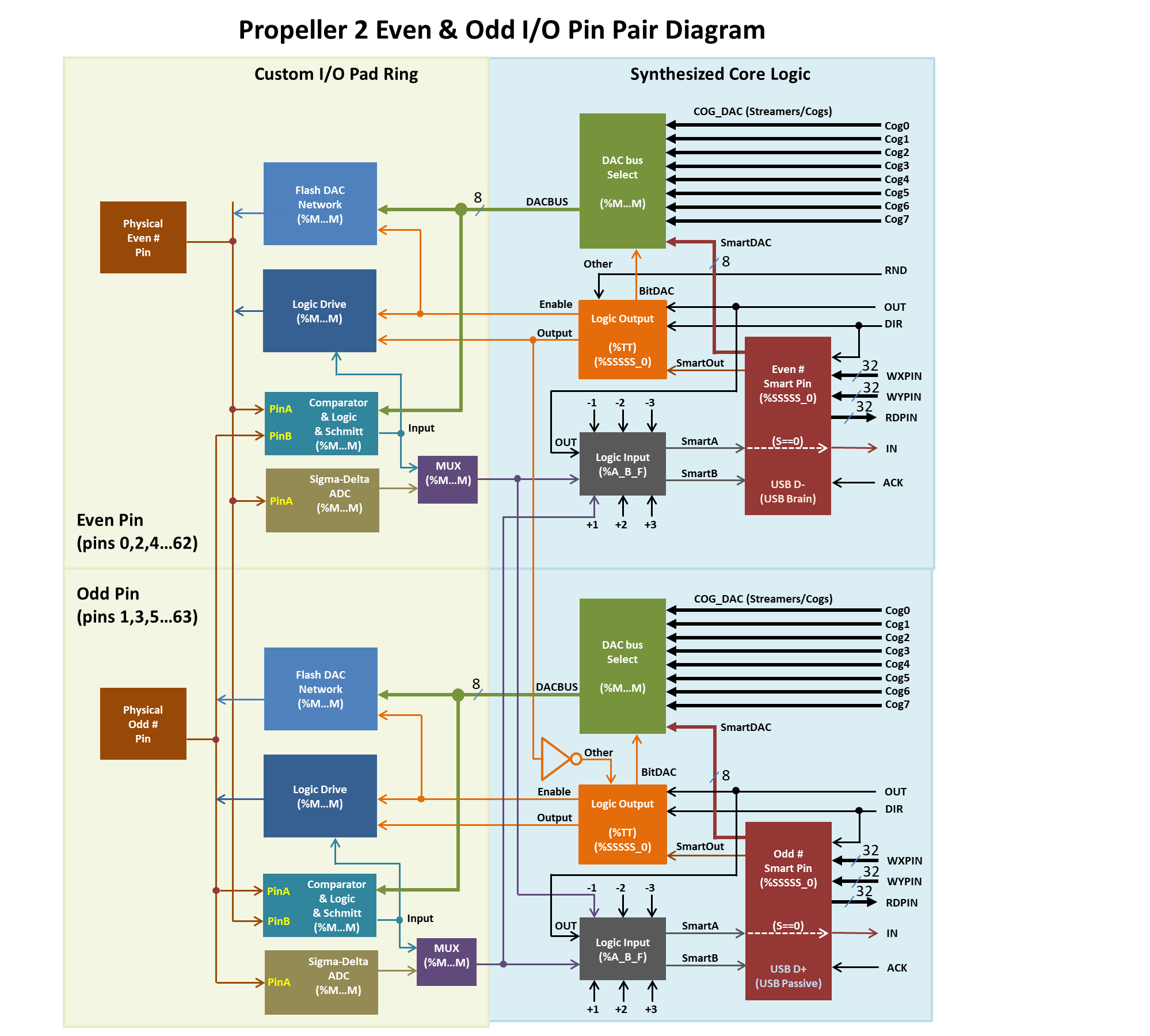

What am I doing wrong here? Apart from the internal pull-ups, I also have external resistors but no joy :|
  • evanhevanh Posts: 17,331
    edited 2025-07-19 16:23
    Chip's A/B labelling is confusing because there is two separate A/B paths. In the following block diagram I've named the low level pad ring A/B inputs as PinA and PinB ... and the smartpin's A/B inputs as SmartA and SmartB.
    Right, having cleared that up, the smartA/B inputs both default to the native pin+0 input. Therefore your smartB input is not currently routed to the expected pin+1. To make that happen the counter's pin mode requires P_PLUS1_B added to it. ie: P_REG_UP_DOWN + P_SCHMITT_A + P_HIGH_15K + P_OE + P_PLUS1_B

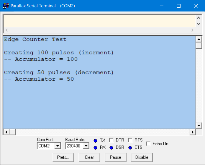

  • I did a little experiment with Spin2.
      pinlow(EDGE_OUT)                                              ' force low
      pinhigh(DIR_OUT)                                              ' count forward
      dif  := DIR_IN - EDGE_IN
      mode := p_reg_up_down | dif.[2..0] << 24
      pinstart(EDGE_IN, mode, 0, 0)
      term.fstr0(@"Creating 100 pulses (incrment)\r")
      repeat 100
        pinhigh(EDGE_OUT)
        waitms(1)
        pinlow(EDGE_OUT)
        waitms(1)
      term.fstr1(@"-- Accumulator = %d\r\r", rdpin(EDGE_IN))
      pinlow(DIR_OUT)                                               ' decrement
      term.fstr0(@"Creating 50 pulses (decrement)\r")
      repeat 50
        pinhigh(EDGE_OUT)
        waitms(1)
        pinlow(EDGE_OUT)
        waitms(1)
    I found it best to setup the direction and pulse-generation pins first. Evan's pin B solution is more elegant than my generic which allows any pin that is +/-3 from the A pin.
