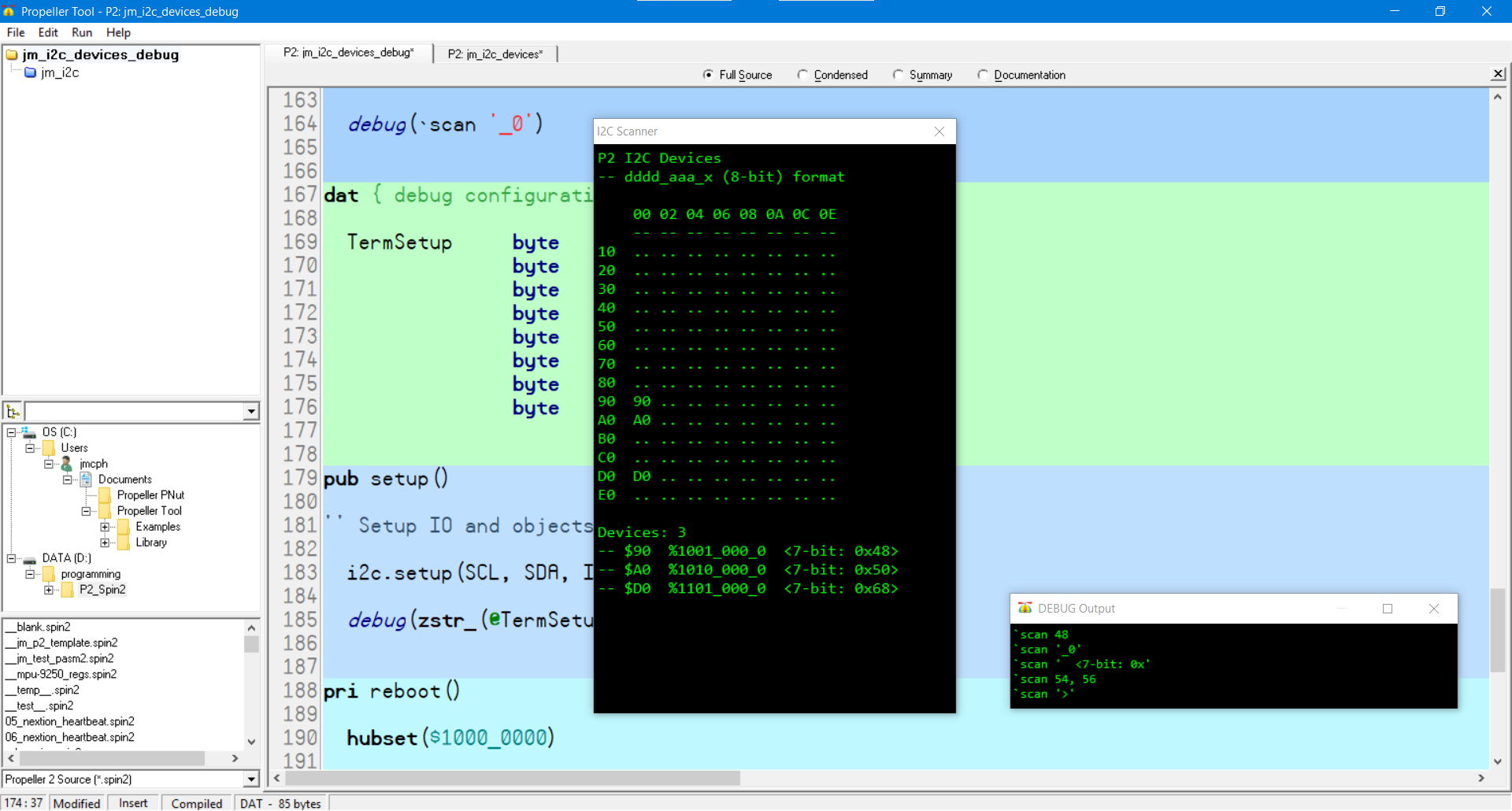

    Slightly improved version of the debug scanner.
    Loops every second.
    Wish could do the matrix view, but that would take some effort...

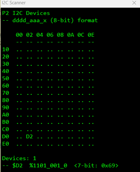

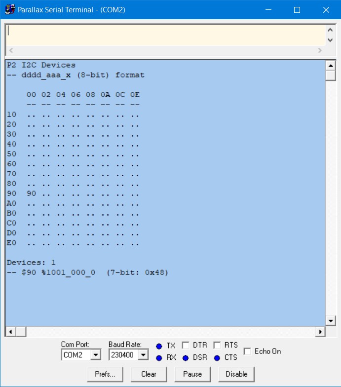

    Here's a version that matches the original (using PST). It would be nice if the term debug window allowed character color to change on-the-fly.
  • RaymanRayman Posts: 16,460
    edited 2025-06-15 16:15
    @JonnyMac Very nice! Didn't know about this "scan" thing. Just what is needed for things like this. That is useful info.
    Seems to work. But, my version of the driver maybe doesn't have "PU_EXT".
    Ok though 'cause had to change anyway:
    I2C_PU = i2c.PU_15K 'PU_EXT

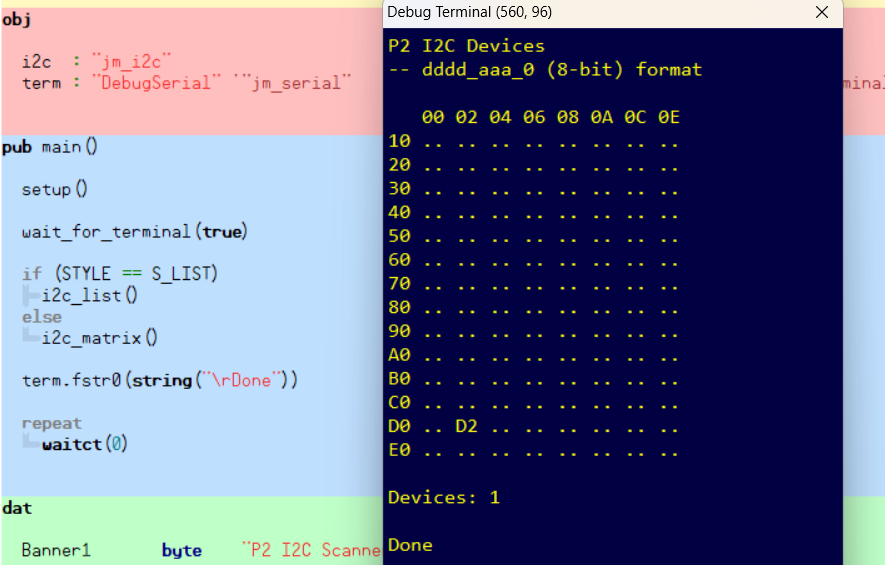

    460 x 563 - 32K
    edited 2025-06-16 15:48

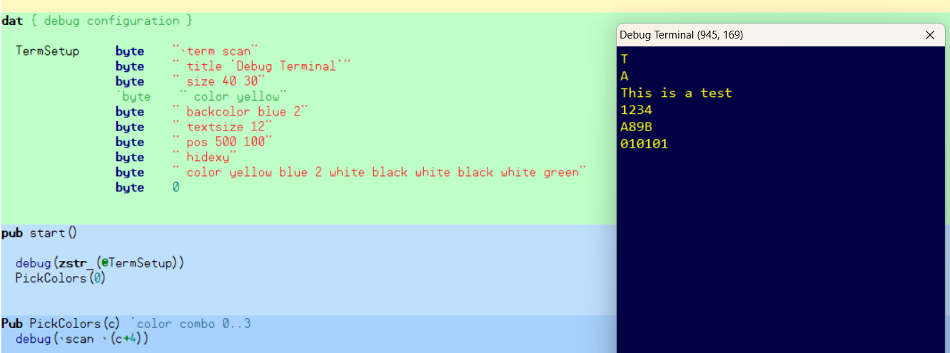

    That is the P2 terminal debug window. Kind of works like an old school text terminal. It would be nice if @cgracey would add
    • row/column positioning
    • foreground/background color updates
    I think with these changes one could mimic ANSI terminal behavior.

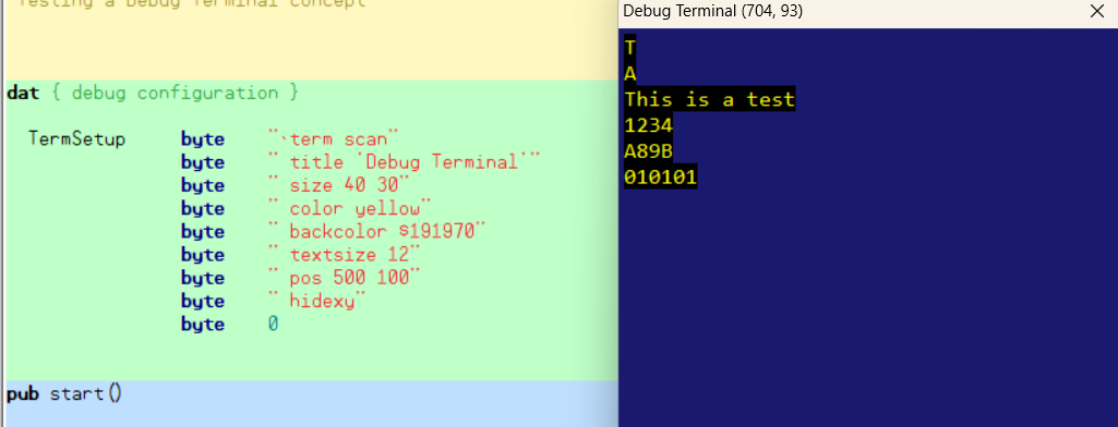

    Just searched the P2 Spin2 docs for the word "scan" and can't find it... Is it there somewhere?

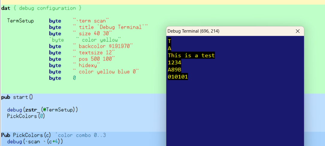

    edited 2025-06-15 20:16

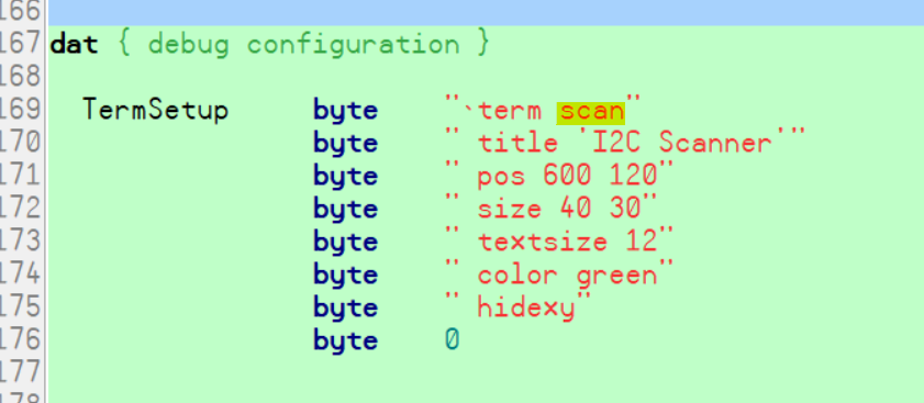

    You have to give your debug windows a name -- I called this one scan.
    Here's my setup for that debug terminal window:

    Think that was enough info to fulfill my wish of using debug like a serial terminal.
    This seems to work...

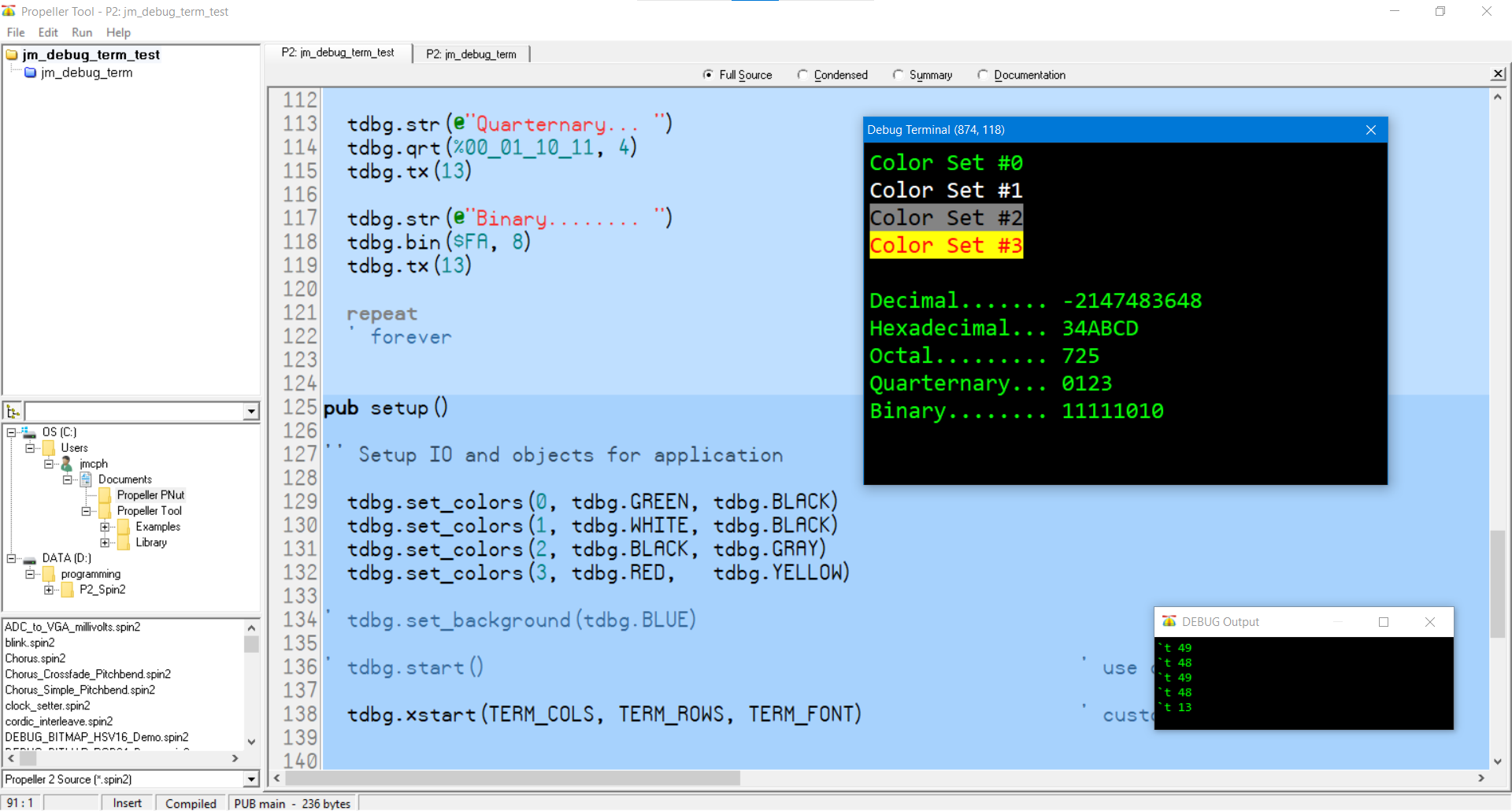

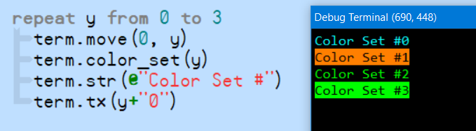

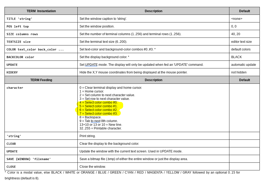

  • You can change colors, but only between 4 that you have to declare up-front
    Thanks @Wuerfel_21
    What am I doing wrong?
  • Like this way, when remember about it, because can set the parameters or not set them as needed.
    I will probably update my version so that passing -1 as an argument sets the default -- I've done that in many objects.
    I saw that but have not seen a practical example of defining the color sets, and there is only four sets which seems kind of limiting. That said, I do have a method in my current object that allows one to use the default color sets.
    I changed my standard color to cyan-on-black since green-on-black is in the default color set (#2)
  • You just put up to 8 colors (foreground/background pairs) after color, like color white black red black green black yellow black
    @Wuerfel_21 Ok, thanks. That works, except "modal" colors, which have to assume means a hex value, seems to be broke.
    Can get around that limitation to some extent by specifying the brightness after. Not really happy about not being able to use a hex value though...
    edited 2025-06-17 04:24

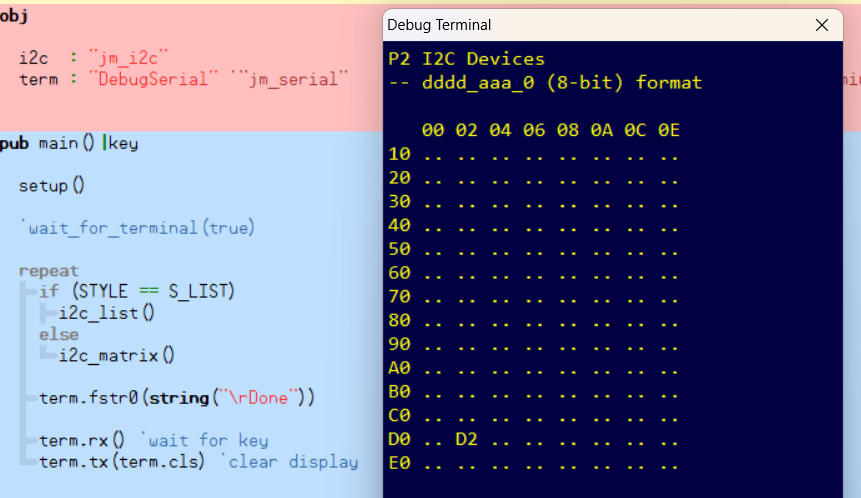

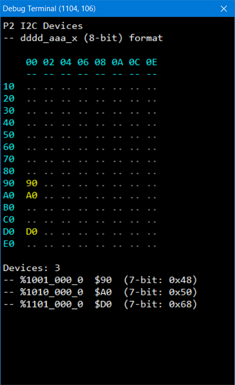

    So, with this hacked version of "jm_fullduplexserial", called "DebugSerial", can use the original I2C scanner by just changing the object, one line.
    Maybe this could work with keyboard input too? Think maybe...
    edited 2025-06-17 05:18
    I added methods for configuring the color set values and the background, though using a level with background (which should be possible) causes issues.
    Still, this seems serviceable.
    Got it to wait for keystroke then erase screen and then redo I2C scan.
    Think this is all that is needed for now... Feeling good about it...

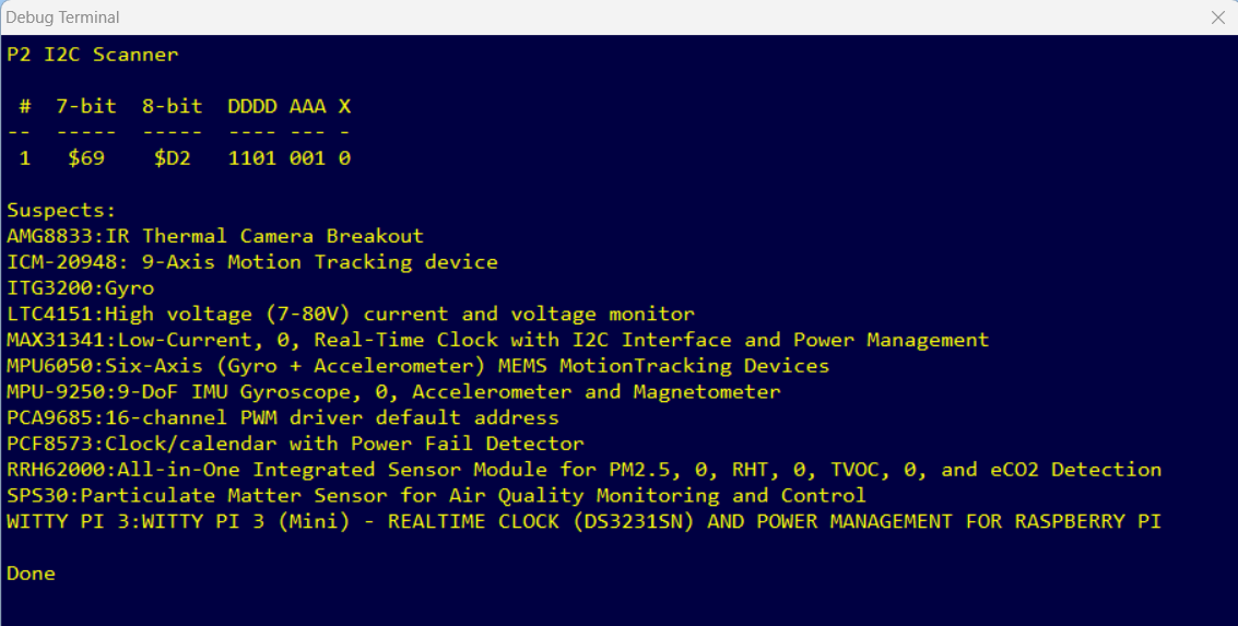

    Ok, one last think want to try...
    Took that 7-bit address list from web and turned from C++ to something that compiles with PropTool in a dat section.
    Maybe not too hard to use to create a "suspect" list from found devices?
    Got it. Lists suspects from 7-bit address in list mode.
