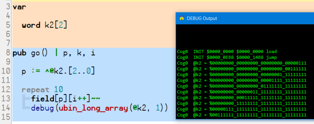

    I tried variation of the example in docs and it doesn't work. No idea why not...
    CON _clkfreq = 10_000_000
    var
    word k2[2]
    PUB go() | p, k, i
      p := ^@k2.[2..0]        'get a pointer to the three lowest bits of k
      repeat 10
        field[p][i++]~~      'set three bits at a time, progressing upwards
        debug(ubin_long(k2))
    edited 2025-05-29 02:07
    I think the problem has to do with debug; you're pointing to a word (k2) but telling it to print as 32 bits. Internally, the upper 32 bits will be set to 0.
    I poked around the debug docs and found a mechanism that will show you what you wanted to see -- and it proves the field feature is working.

    Interesting... Was wondering if it work with bits offset from LSB, seems it does:
    var
    word k2[2]
    PUB go() | p, k, i
      p := ^@k2.[3..1]        'get a pointer to the three nearly lowest bits of k, starting at bit #1
      repeat 10
        debug(ubin_long_array(@k2,1))
