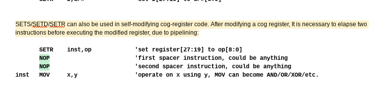

  • RaymanRayman Posts: 16,460
    Guess one need two NOPs with self-modifying code to be safe?
  • Wuerfel_21Wuerfel_21 Posts: 5,864
    edited 2025-05-20 16:29
    Yes, but that's documented and (I hope) well known.
    (it most usually will give you the old value, so there'd be a bug, anyways)
    I was looking around for such "documentation" but couldn't find anything on self-modifying code... Have you seen it somewhere?
    P2 silicon doc, but I don't think where I originally got it.
    Ok, thanks. Know what happened... Tried to use the Edge search, but that doesn't work in Google Docs, have to use their search :(
    Still seems like there should be a section titled "Sefl-Modifying Code" with that note in it...
