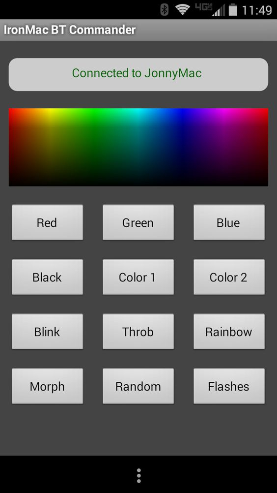

    Again, for simple command programs like this uses ASCII characters or strings. If you have to send a value, then you can use regular bytes -- but I don't. I send EVERYTHING as strings. The attached image is a program I created with MIT AI2 to control an add-on I made for the DEF CON 22 badge (that I co-designed and coded). Even values from the color strip are sent as a string; the Propeller converts the string to a value to be put onto the pixels.

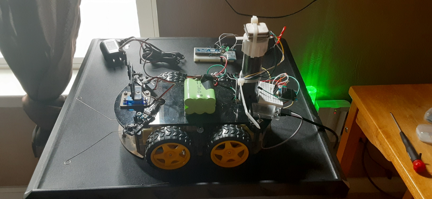

  • Got a chance to work on this again. Everything works now... even rxtime() works. Put the BT module on the robot... that works.
    Prior to getting the BT module, I got the robot to go to a GPS spot, that I coded into the spin program (the compass helps). Now I can use the MIT app to send GPS coordinates to the robot. Attached a pic of the robot. You can see the GPS/compass (BE-880) module on top of the PVC pipe. I did some reading on the compass... it suggested to mount the compass away from any electronics.
    Although the GPS module works, I am finding that it's not real accurate. I am using the robot upstairs, in my house. That might have something to do with the accuracy... although, after a few minutes, I am getting 12 satellites.
    Thanks Jon for all your assistance. Have a good one.
