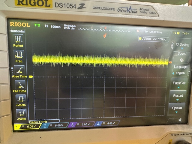

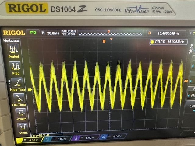

I have a plasma CNC that uses a strange limit switch method. There are 3 wires that go to 2 limit switches that are wired NC one wire seems to be common to o both switch’s. Each switch then has 1 wire connected to its port labels Lim1 and Lim2. I cannot find any obvious optocouplers on the board. It’s sparse. It seems like these pins go direct to a small micro (not sure what it is). But cant be sure. On a volt meter the voltage on each of the 3 wires shows AC 10v. Very small DC. When you press a switch ( opens the circuit ) all the 3 wires show the same voltage. I put a scope and you can see the frequency and voltage. The scope never changes when you press a button. I know the buttons and system works because I can home the machine and it sees the switches.
Since it is not making or breaking a signal my guess is this is a current based scheme. The wires are all unshielded to the switches which are inches from a plasma cutter nozzle often.
Any ideas what is going on here? I have some random issues with the machine and want to rule out the limit switches.

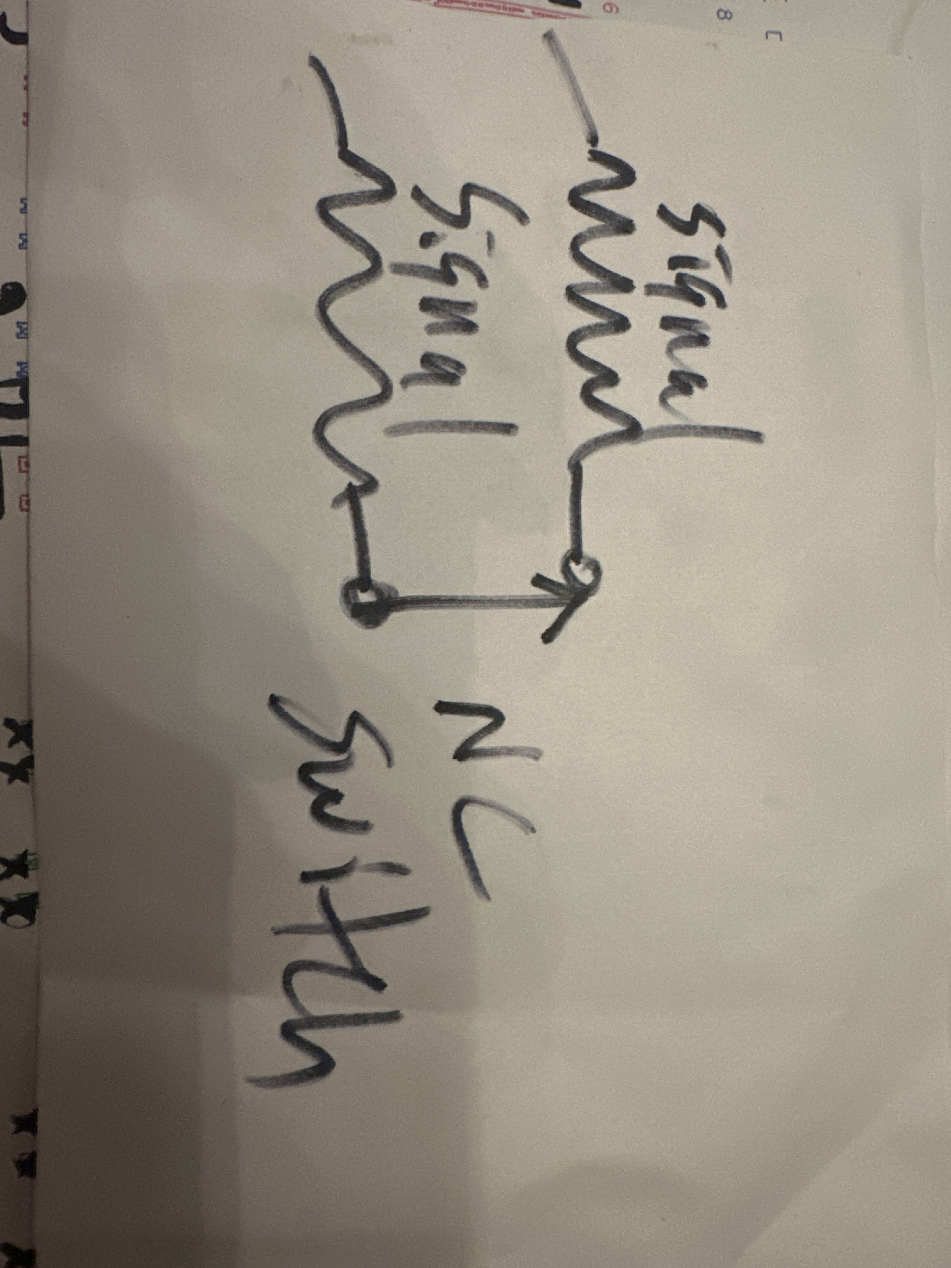

    What if you have 2 signals like that shown. The limit switch in NC combines the signals and some device sees twice the current even though the voltage stays the same? I assume this odd scenario would be less prone to noise problems which is why they did it since a static voltage via pull up resistor to a switch would be simpler.

  • Put a 10 ohm resistor in series with the wire, trigger the sensor and see if the voltage changes across the resistor indicating a milliamp change . Current
  • Or a phase shift

    This is the circuit for one switch.
    Let’s say this is some current sensing circuit. Would that be used for better noise immunity on the lines? They used unshielded cables on the switches next to a 50 amp plasma cutter.
  • The voltage does not change when pressing the switch so I assume this means there is no phase change ? Else there would be voltage change right?
  • I can test the resistor idea in a day or 2.
  • Could be RF pickup that you have. The signal you see is a carrier signal. Then a peak detector senses when you pass metal in front of it. Like listening to AM radio and when you walk past the radio it causes the station to fade in and out.

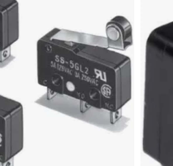

  • The switches are basic lever switch’s. The limit switches work fine. There’s other odd behavior on the software that makes me think it’s noise.
  • That’s what I use on my cnc table is the good old micro switch.

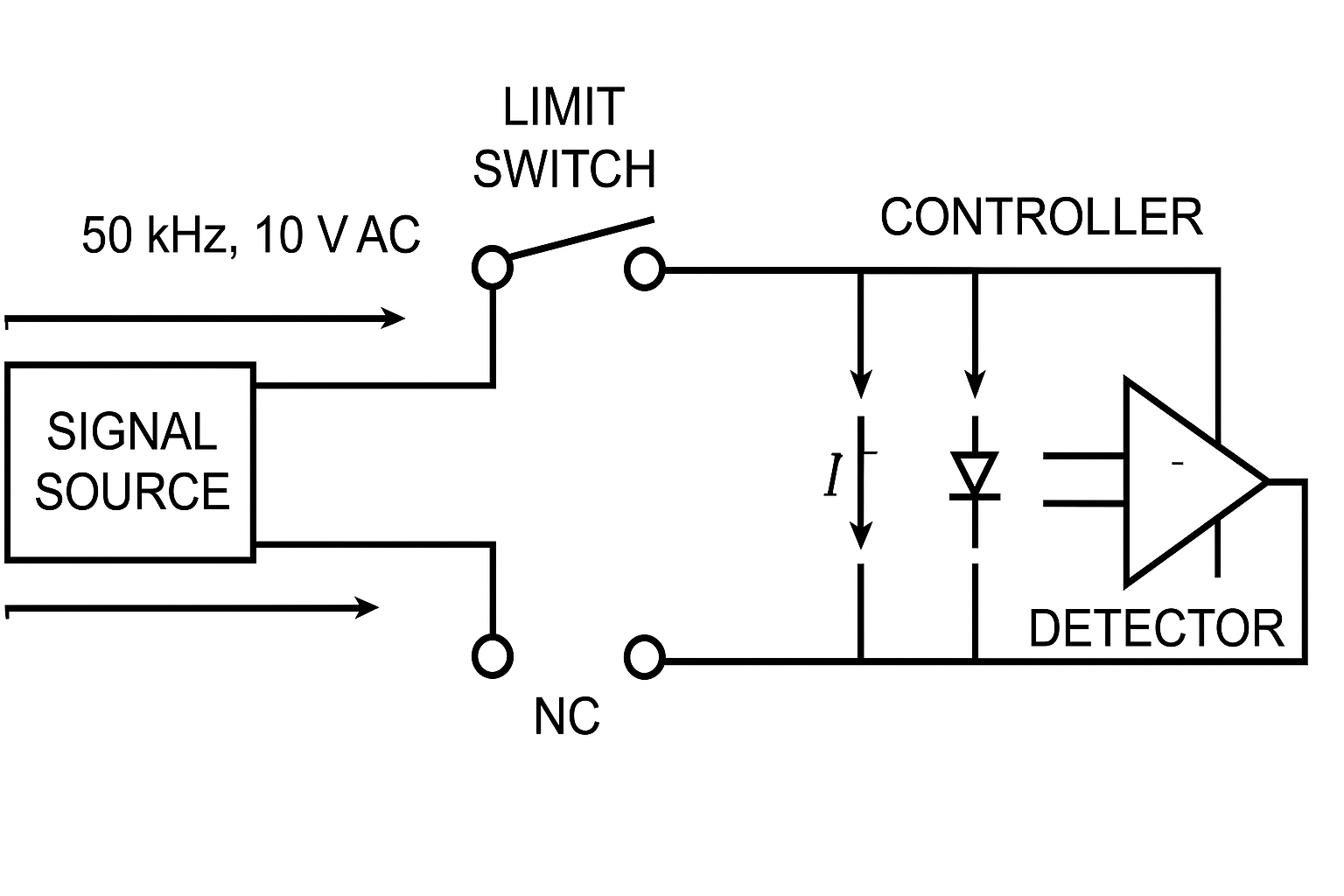

  • Chat gpt response.

    Would you like me to also draw a simple block diagram of how this system is likely wired internally? (it might help you visualize it even better).
    I can do that if you want!
  • Image.
  • Yes if you don’t mind that would interest me
  • Thanks

    I told it you said yes! It made the image above. The switch is not drawn correct. NC should be closed.

    Those type wirings are always simple 24VDC circuits. Your problem is your scope is not referenced to that circuit's ground. All you're seeing is floating RF noise from a nearby modulated motor/VSD/servo wiring.
    First thing to always do is go get the machine's wiring diagrams. Even if it's in Chinese, having a diagram is better than not.

    I’ll test this again. Wiring guide shows nothing but where to plug things. No info. Scope GND is to chassis but I’ll look for a PCB separate GND. I thought it would be odd to have a very consistent 10V AC voltage on VM that agrees with the scope peak to peak 20V.

    Right, frame/case/chassis is always AC earthed. AC earth is almost never connected to the 24 V control supply. And internal logic supply will typically be isolated from the 24V too. Optocouplers and transformers are everywhere in industrial circuit boards.
