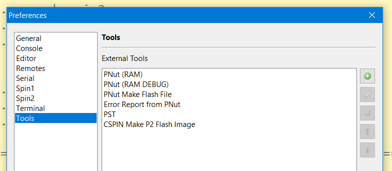

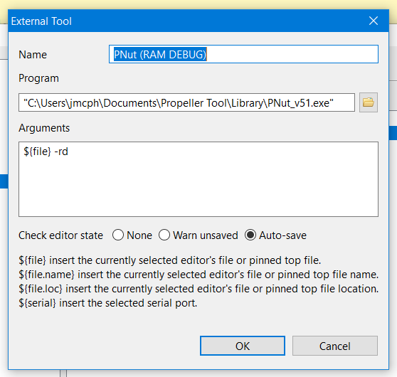

    According to Chip, Jeff will be updating Propeller Tool to the latest version of PNut (it's out of date now). I still use PT for coarse editing mostly for the Alt-Drag-Select feature, for the bookmarks, and for the code folding in the editor pane (ST has an outline view but I find the colors in PT helpful). If you don't need those features, you can use Spin Tools and have it call the latest version of PNut so that you can do any kind of debugging. If you need simple debug statements, that's built into Spin Tools and is nice because it's in a scrolling text box, so you can go back through (can't do this with PT without logging the debug session). Marco has added the graphic debug windows as well.
    Since I asked him for it I have taken advantage of the External Tools feature in Spin Tools.
    This is the setup for compiling with PNut and loading into RAM with debug enabled.
    You do have to save the file for external compilation -- something not required inside Propeller Tool, but is required in PNut.
    If your Windows paths have spaces be sure to put everything in quotes.
