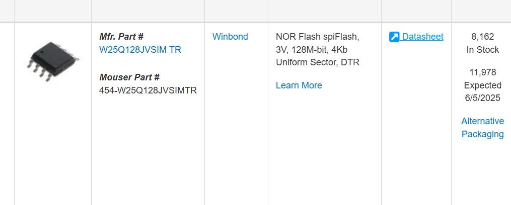

  • RaymanRayman Posts: 15,899
    IDK, both Digikey and Mouser show the SOIC part as having the DTR feature, unless I'm missing something...
    Wondering if it was always there, but just not advertised at first or something...

  • evanhevanh Posts: 17,011
    edited 2025-04-21 17:00
    Yeah, you're right. I've had a read now and yep, all the new parts are "DTR" capable. It's not quite full DDR. That'll be why they are naming it DTR. It's akin to QuadSPI/DualSPI, ie: DTR doesn't apply to the command. But it's also applied on top of those - So you can have any of SPI/DualSPI/QuadSPI/QPI combined with DTR.

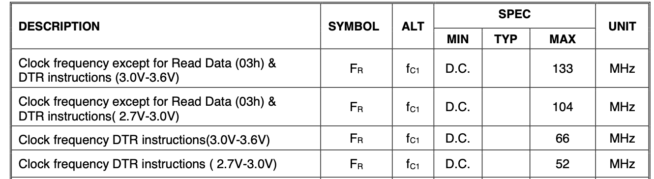

    Looking at the data sheet, it seems strange that DTR operation halved the maximum clock rate from 133MHz to 66MHz. Pity about that. Otherwise it could have transferred bulk data significantly faster in this mode. Perhaps they are gearing up for the rate to be sped up over time in future parts using this same interface. Without the DDR actually clocking the data faster the only real gain you get from DTR is by sending the lookup address out using multiple data lanes instead of just one. I do like the continuous read mode operation though, that could help a little bit too for repeated read transfers, at the expense of driver complexity and maintaining some extra state; it seems intended mostly for XIP usage. For long sector length transfers it'll hardly make a difference however.
    https://www.winbond.com/resource-files/w25q128jv_dtr revc 03272018 plus.pdf
    Not sure that is right. There is a 66 MB/s limit. Maybe 66 MHz is for quad operation with dtr?
    Ok, took me a sec to decipher that... That 66 MHz is referring to the low speed "Read Data" command. You have to use the "Fast Read" command to go high freq...
  • roglohrogloh Posts: 6,210
    edited 2025-04-22 12:29
    Are you sure, @Rayman? I read it such that it appears that the DTR instruction transfers are limited to 66MHz but it's not 100% clear. Do you believe it is only applying to the initial instruction component of the DTR transaction and data can be subsequently clocked at 133MHz DTR? That would be good if true - and may make more sense why the feature was provided in the first place.
    Here is the related snippet from the original data sheet.
    Actually in the features section it lists this:
    • 66MB/S continuous data transfer rate
    So it would appear that it could clock a nibble on the rising and falling edge of a 66MHz DTR clock making 66MB/s in 4 bit mode. Ugh. No 133MHz operation then. :(
    Ok, yeah, guess it is 66 MHz. That jives with "equivalent clock rates of 266MHz (133MHz x 2) for Dual I/O"
    Unfortunate if true. Seems you need QPI to get full speed...
    Now, I don't get the point of DTR at all. Why have double transfer rate but at only half the clock speed? Don't see how that buys us anything...
