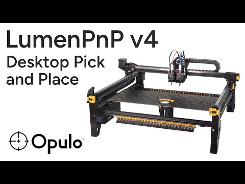

  • RaymanRayman Posts: 16,461
    Also like the price of this one, mentioned at openpnp:
    https://pandaplacerstore.com/products/pandaplacer-a1
    $750 but you have to 3d print some things yourself, like the feeders...
  • I am closely following Stephen's project more than 4 years. In the meantime I've seen many other P&P and CNC but noone convinced me as this.
    This is opensource project, based on OpenPnP software.
    https://github.com/opulo-inc
    https://github.com/sphawes
    I've seen another briliant idea for automatic head exchange from a german guy which I am implementing together with a conveyor. For the latest I will use a similar transport&clamp solution, again ingenious and at the same time effective and cheap, which is familiar to me (from ATON and HORUS AOIs).

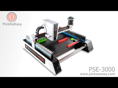

  • Anyone seen this openPnp machine? Could be another contender, though I’ve not seen any reviews. Uses “standard” feeders apparently.
    PSE-3000 looks good. Price is decent. But, store is flimsy. Seems you have to email to order. Also, have a feeling will be shipping from China...

    But, over $800 and originally from China gets a crazy tariff now...
    And, coming from Canada adds some extra on top...
