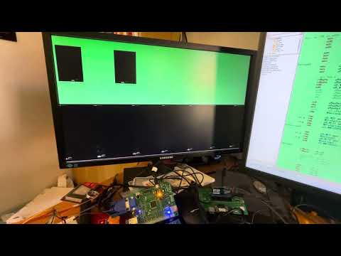

Anyway, here's a video of a test with wake word "robot":
The blue LED on the bottom right lights up when word is detected.
You can see in video it's not perfect, but pretty good. Needs some work to beat Alexa...
The code is rigged to use the left button of a USB mouse to enter in reference word. You hold the left button down, say the wake word, then release.
Wake word is captured and displayed in top left window.
Current input is shown on the bottom, like Chip's original, but it's windowed to only look at a certain frequency range.
The input is constantly copied to the top sorta-middle window and compared to the reference.
Right now the algorithm is just looking at the sum of squared errors.
Blue LED is lit when error is below some threshold.
Also looked at using the sum of vertical lines in the sample. It's shown under the samples. Hasn't proved useful yet but might be...
