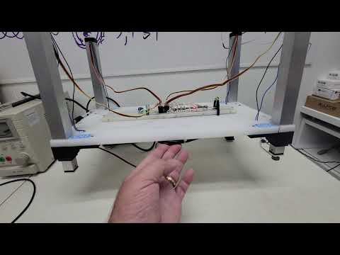

    Going down a similar rabbit hole a few years ago for a client, I designed a self leveling platform (Think Shipping Container).
    When first designing the code, it looked like the thing was at sea during a storm before I got the algorithm just right.
    Here is a scale model proof of concept I put together for the client before the funding approval.
