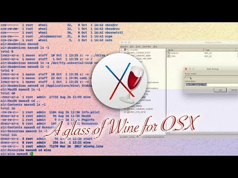

  • OK, I have the parallax PROPTOOL Working and i can COMPILE F8, i can open and save files. I have set up my syntax scheme to my licking.
    BUT..
    I cannot see how to get the serial ports working?
    I have installed the latest FTDi drivers and i have the propeller development board for 15 years ago, i have powered it up, but no success.
    I
    Can anyone tell me how to sort out the serial ports on a mac using propeller tool running in Crossover.
    I am using MAC OS Monterey.

  • evanhevanh Posts: 17,252
    Hmm, looks like it's not automated - https://www.codeweavers.com/support/wiki/mac/mactutorial/usbtoserial2

  • OK, I tried the instruction in your link to code wevers,
    But it did not work. nothing is showing up in propeller tool ports.

  • yes, wine/crossover is a pain!
    I still have one other test to try with crossover/wine, i found this video on youtube which may help, haven't tried it yet
    but also I think i have Propeller IDE working. at least the serial port works.
