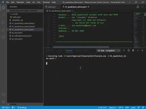

  • Since I only code in C and don't use the setup from Marco.
    I use this task to compile my programs:
                "type": "cppbuild",
                "label": "Build FlexSpin Propeller P2 Program",
                "command": "d:/flexprop/bin/flexspin.exe",
                "args": [
                    "-2",
                    "-O1",
                    "-I",
                    "D:/flexprop/include",
                    "-I",
                    "D:/Custom",
                    "-o",
                    "${fileDirname}/build/${fileBasenameNoExtension}.binary",
                    "${file}"
                "options": {
                    "cwd": "${workspaceFolder}"
                "problemMatcher": [
                    "$msCompile"
                "group": {
                    "kind": "build",
                    "isDefault": false
                "detail": "compiler: flexspin.exe"
    I like to compile my programs in a build folder so that it's not adding files to the source directory. Works great with flexprop.
    I use this task to run the program using com5:
                "label": "Run Propeller Program --> COM5",
                "type": "shell",
                "command": "d:/flexprop/bin/p2loader.exe",
                "args": [
                    "com5",
                "problemMatcher": []
    But I like to use WiFi so I have a custom WiFi loader:
                "label": "Run Propeller Program --> WiFi",
                "type": "shell",
                "args": [
                    "wx-de073e",
    I setup this configuration for working with the source code in C:

  • @VonSzarvas
    https://www.parallax.com/visual-studio/
    Looks like missing videos to do the process. Tried Youtube, no luck. I assume the process is straight forward but I can't follow the steps without the missing? videos.
    Thanks.
    If I am missing something please let me know.
    Thanks in advance.
    Martin

  • VonSzarvasVonSzarvas Posts: 3,633
    edited 2023-01-12 10:36
    @pilot0315 said:
    @VonSzarvas
    Thanks.
    Thanks in advance.
    Martin
    Something curious afoot! I see all the videos at that link, starting at Step 3.
    Could your browser, ad-blocker, IP filter (etc..) or firewall be blocking the links/feeds somehow ?
    For testing, here's a direct link to one of the videos from that page:
