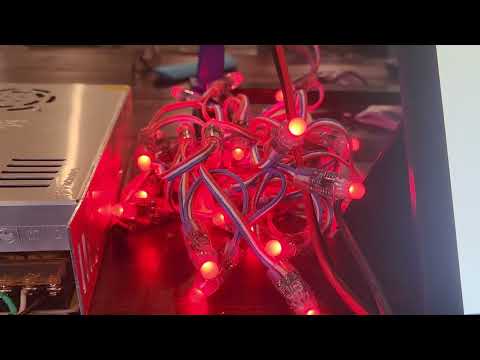

  • I hopped on Discord and @Wuerfel_21 helped me understand what to do for this specific use case. The code in question is as follows:
                    mul lbrightness,##652
                    movbyts lbrightness,#%%1111
                    mulpix pixel,lbrightness
    And here is the result:
    Thank you all so much!
