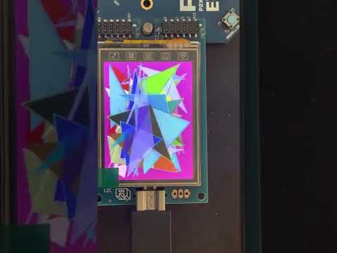

    Just got the QWIIC connectors needed to complete the 2.4" LCD boards.
    The cogged version of the driver is crazy fast, compared to the P1 version:

    QWIIC connectors soldered on, so these 2.4" TFT toushcreens (with Nunchuck and QWIIC) are now available see it here.
