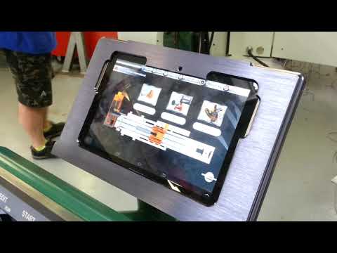

    I have harped-on about the fact that; most of us are carrying the most powerful HMI ever...Why bother with a dedicated screen.
    Most breakdowns I get involved with are dead due to the HMI which is subject to constant abuse/misuse.
    Tomorrow, I visit a customer to fit his new user interface which cost several thousands but nothing compared to the lost production. Crazy!!!
    One of my Android devices that replaced a Siemens system:
    Craig
