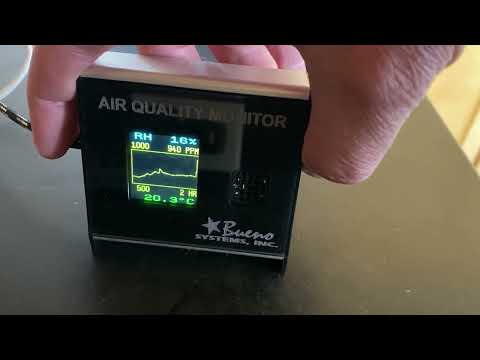

  • I have one of these in my office and it's really fun to watch, especially with the colorful display. Here's how the button changes the time continuum display:
  • Thanks for that video, Ken!
