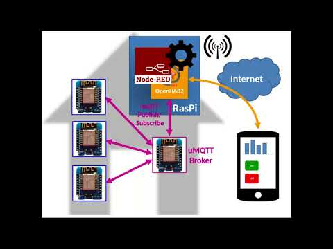

    Here is MQTT running on the ESP8266
    https://github.com/martin-ger/esp_mqtt
    Here is the 17 minute video.
