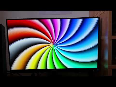

Yet another spiral demo. This time in Spin, using my HDMI driver :)
A demo code is now simple :smile: but compiles only with Flexprop. Propeller Tool doesn't like accessing another object's variables.
 CON
 _clkfreq        = 200000000
 hdmipin         = 8
 obj               v: "hng023"
 pub demo() |x,y,px,py,d
 v.start(512+256+192+48,hdmipin)
 repeat y from -248 to 247
   repeat x from -448 to 447
     px,py:=xypol(x,y)
     v.putpixel(x+448,y+248,(py+px<<20)>>24)
 repeat
   d:=long[v.palette_ptr+4*255]
   longmove(v.palette_ptr+4,v.palette_ptr,255)
   long[v.palette_ptr]:=d
   v.waitvbl(1)

    Yes, good, old, vblank synchronized palette trick :) Setq2 allows reading all 256 color palette every frame in every vblank
    Now, how to do this using a Propeller Tool? It also doesn't like to call putpixel, which is a variable (a method pointer) in the driver.

    Yes, it is 896x496x60Hz, the maximum resolution at which the driver (or rather P2 memory) allows 8 bpp - 446400 bytes used by fb and display list, less than 100 kB left
    A lot of pasm is used in the driver :)

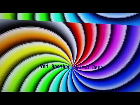

    You can also rotate a display list :)
    hdmipin         = 8
    obj               v: "hng023"
        px,py:=xypol(x,y)
        v.putpixel(x+448,y+248,(py+px<<21)>>24)
    repeat
      d:=long[v.dl_ptr]
      longmove(v.dl_ptr,v.dl_ptr+4,495)
      long[v.dl_ptr+4*495]:=d
      v.waitvbl(1)
