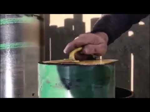

I am writing to this forum on the advice of a phone conversation with Ken @ Parallax, about getting the bit and pieces put together for a laser measuring device my company is hoping to put together.
I know we would like to stay in the under 5V platform to be able to throw in batteries on demand (Most likely AAs) and it needs to be pretty accurate.
We are currently using a DISTO D8 (Now discontinued, but a link may help with a written/visual aid: https://www.distagage.com/Disto-D8-p/764558.htm) which we have heavily physically modified to either:
1) Block access to buttons which reveal functions/commands that aren't useful or may be detrimental
2) make it usable in our field of use (Oil field)
If it was only an enclosure issue (which we have fixed via a 3D printer, I doubt we would want to make the change, but since the best path or work flow for us is to take a series of linear measurements and dump the data into an excel spreadsheet, it is very inefficient that the measuring device we currently use is locked at save only 30 measurements at a time before it simply overwrites itself. If we had a device that could hold 500 or more before being data dumped into the computer it might honestly cut the time down from a job by more then 75%.
If anyone here is able to point me in the right direction, or has any questions, or any ability to assist in this project, that would be awesome.

    Russ is looking for an engineer to create the solution for them, which is not necessarily a product. They need a laser that can measure 50 feet with sub-cm accuracy, and stream the data into a PC application. I think we already have the software https://www.parallax.com/package/plx-daq/ so it's a matter of a laser module and microcontroller to stream into Excel. They need to move away from the limitations of the handheld device shown above.
    Can anybody identify a laser suitable for 50' with very high precision and accuracy?

    Thank you for the list. I found it informative. I actually have a general question involving accuracy/resolution.
    We see most of the items on the list as having a +/- 10CM accuracy, which a non starter for us, but as we a taking a "saved" measurement every 4-5 seconds at most, and we are not actively scanning terrain, Im assuming the accuracy for our application should be, on average, much higher then listed?
    The youtube link above should give a pretty decent picture of product use.
  • https://lightwarelidar.com/collections/lidar-rangefinders/products/sf23-b-50-m
    Obviously if given the choice, this seems to be best fit. Easy choice to sacrifice measurements per second for battery use.
