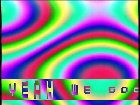

Here's something I wrote while messing with @rogloh 's video driver. It displays a classic plasma effect and is an example of of using scanline rendering. Or I guess an anti-example, accounting for the different video modes needs way too much code for my taste.
I have included pieces of code for interlaced and progressive TV, as well as 640x480 and 1024x768 VGA, but you should be able to setup whatever you want.

ahhhhh why did you say that now I had to actually do it.
Will have to record video later(tm).
The 704x480i mode is kindof crash prone. I had to overclock it very high to get it to fit with reSound. I think tweaking the PLL settings might help a bit. Also had to change the VGA mode from 1024x768 to 800x600 to increase the clock enough, but that seems stable.
I also wrote an obnoxiously long scroll text. Can you read all of it without dying of boredom? No cheating!

Here's a video for all you lazy bums and non-P2-owners:
Annoyingly I figured out how to fix the flagging after recording this....
The audio is through the RCA jacks, but in DC mode because dum dum.
Nice, one of my fav demo routines... One thing that sets this apart from plasmas I've seen in PC demos is it's soooo nice and fluid...
