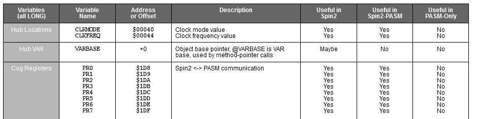

getct pr0 ' get current clock count . . . getct pr1 ' get current clock count
It doesn't appear flexprop_5.0.8 supports/defines these Spin/PASM cog registers/variables, is this true or am I missing something?
They are useful in sharing data between Spin and PASM or just having them available as local variables for use within inline PASM or Spin.
