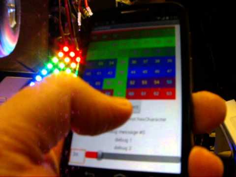

    I've used the HC05/06 modules for many years in conjunction with Tachyon. Once Tachyon has been loaded onto the Prop then all other programming and "commands" can be done over Bluetooth. There was one project I detailed on a Google doc that scheduled driveway gate opening and closing times as well as allowing for remote control over Bluetooth and RFID entry and logging etc. I have used a couple of different Android apps including "Serial Bluetooth Terminal" by Kai Morich which includes user configurable buttons that I might load a command like OPEN or CLOSE onto but still have the serial terminal console available.
    I also modified one of these apps for a tablet so that I could control the color and size of characters and backgrounds etc via Bluetooth. This was especially important since it needed to monitor and provide operator controls for 1.5MVA "regulator".
    SInce I use a 4x2 connector or a 5x1 in place of the 4x1 Prop plug connection, I also have +5V available on the header so it is an easy thing to plug a Bluetooth module in on the serial port of my board.
    BTW, Tachyon has an on-chip OBEX practically and also includes WS2812 drivers and high-level operations..

  • This is a modified Bluetooth terminal running on a cheap tablet and using a HC06 talking via Tachyon.

    I made a simple phone app with Android Inventor -- I don't know if there is a similar tool for iOS products. This app was used to control a WS2812 add-on board for my DEF CON 22 badge. I added an HC05/06 radio to the badge and used a similar text input strategy. The Android app simply sent the command strings to the Propeller. The fun thing about this is that you can do your initial testing through the programming port. My friend Peter will smile and point out that he can do that anyway, because Tachyon (his version of Forth -- that I haven't yet mastered) is always live; this gives him the ability to update his application at any time. I do my coding in Spin, so my route is a little more traditional.
    The point is, you can do this -- and it should be fun.
