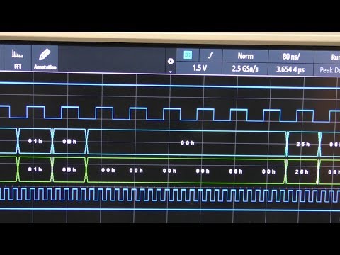

  • Yes it could be easy to solder some green kynar wire to the header. But probably we might not need it.
    Please check this video from Mikeselectricstuff (Sep 1, 2018) ->
    No need to watch all 30 minutes. Interesting talk starting from 15:52 up to around 24:00
    Specifically, Data_Valid synchronization start issue -> 16:40 - 18:22
    Synchronize when all (CRS_DV & D0 & D1) are High
    "That point we know it is a known position within the frame"
  • Neat video, clever use of data pattern to sync to SFD. This combined signal pattern is late though and would likely be too late to start the streamer. I guess you could do something like the following though...
    1) wait for the first low to high transition of CRS_DV, timestamp it and start the streamer capturing bit pairs to HUB RAM
    2) wait for the logic pattern high, high, high on RXD0, RXD1 and CRS_DV, or timeout
    2a) if timed out, then abort streamer reception and wait for idle and restart
    2b) if not timed out, capture exact P2 clock time and compute number of clocks since the timestamp so you can figure out real start of packet in HUB RAM as an offset from start buffer
    3) wait for end of the packet by waiting for some time after CRS_DV drops low (tricky if muxed with CRS and toggles in RMII v1.2 mode)
    4) stop streamer, write real packet start offset and length into circular rx buffer, and restart capture process for next packet.
