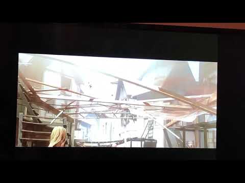

I previously posted about a video player from uSD using FSRW: https://forums.parallax.com/discussion/171570
Just hacked that to use the new FSRW for eMMC. eMMC has an 8-bit data bus, so is much faster.
Can now do 480p widescreen video at 30 fps and 16bpp. This looks way, way better than that QVGA in 8-bit indexed bitmap.
Also demonstrates using a single buffer for video. Don't have a choice as each image is 342 kB. It can actually go at 60 fps (did that by accident).
Video has to be widescreen though because a full frame image won't fit in RAM. (Or, maybe there's a way around that?)
File size is ginormous. I could only put half the movie into one file because 5 minutes of this hits the 4 GB file size limit of FAT32.
Anyway, here's a video of it working. Somehow I managed to get the audio out of sync. I'm not sure how that is even possible though... Have to look into that sometime...
