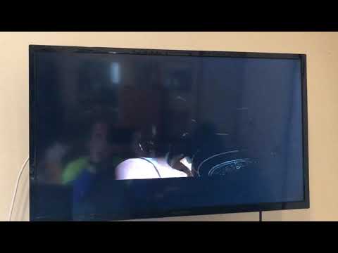

It works!
Source code attached.
More info and program to create video is here: http://www.rayslogic.com/Propeller2/P2Video/P2Video.html
  • Very cool. What resolution & frame rate are you targeting?
  • RaymanRayman Posts: 16,460
    Very low on both
    But maybe just ok
