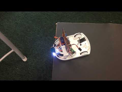

Much less high-tech are these simple IR reflective sensors, just an LED and phototransistor in a housing, model TCRT5000. https://www.ebay.com/itm/20Pcs-TCRT5000-Reflective-Photoelectric-Switch-Infrared-nw/254476633129 20 pcs for $4 shipped. I've had some for a while, never used 'em until now. I needed a simple cliff sensor so a robot hopefully won't fall off a table. As always, I want the simplest, minimum part solution, so some experimentation with analog circuitry was in order. I came up with the hastily-scribbled two-resistor circuit, saved here for future reference and anyone who might want it. Those are 1K and a 100K resistors. This 5V circuit is adjusted to output logic-level signals that can be read directly by an input pin, transitioning from low to high at ~1.4 (BASIC Stamp!). Sensor positioned ~3/16 to 1/4" above the floor, looking downward. LED draws 7mA. Nothing sensed (looking over the table edge) gives ~0.5V output (LOW). Anything sensed gives much higher voltage (HIGH). White surface=5V, black plastic or electrical tape =1.65V. Simple 2-resistor circuit works for me.

    These IR cliff sensors are working great. Here's a worst case scenario, a flat black tabletop surface.
