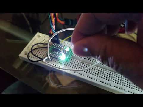

    Referencing the man in the cardboard donut, capacitive sensing might work (albeit you might have several false triggers) .
    Here is a differential sensor I am currently working on to sense a fluid level "fill line" ... scale that up a bit where the wearer is literally one capacitor plate "the reference capacitor" and anyone (or thing) approaching is the other capacitor plate.
    Proof of concept video:
    In the video, the two wires are essentially the capacitors... this is a proof of concept test for a differential capacitor concept. The reason for using two capacitors this way is that you can negate any common mode noise. This allows for greater sensitivity.
