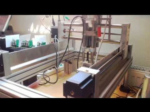

  • BTW, the schematic shown in post #1 has a BOM cost of ~$3.50 and takes ~1 square inch of board space. It can output up to 4 or 5A at 48V depending on cooling. That is enough to make a small router run as fast as this:
    (The control box has two P1s inside)
  • evanhevanh Posts: 17,313
    Nice. Any specific homing for the two X axis motors?
  • The machine shown is very simple and has only one homing switch for both X motors. This is sufficient as the gantry is small and stiff enough so it can't twist. For larger machines I also support two separate homing switches to ensure that X is always right angle to Y.
