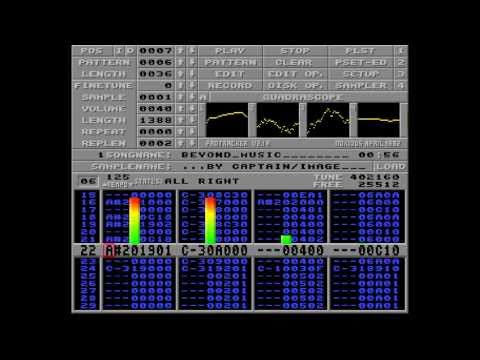

    The music is from the Amiga days and is completely sample based. No synthesis or compression at all. Just playing different 8 bit samples with realtime (50 Hz) control of pitch and volume into 4 audio channels. The note data, effects and samples are all in the same file, hence the name, "module". The cool thing is that the Amiga did all this in hardware in 1985 with 4 separate DACs that each could output arbitrary pitch and volume. No mixing involved.

    Here is a clip from a module tracker editor running on the Amiga. You can visually see what's going on. Each note scrolls into position and triggers a sample with some pitch and volume. The numbers beside each track are effects like pitchbend, portamento, vibrato, tremolo and other things. These effects gets updated at 50 Hz on a PAL Amiga (which is the default because the Amiga was a big hit outside the states)
