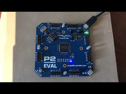

This may very well be one of those “If you have to ask.....” situations. I short circuited my P2 on my rev B P2-EVAL Board last week and I’ve already got 4 replacement ICs from the original order. My plan was to use those for a new board, but I really need to flesh things out on the EVAL board more. So, I plan to desolder and replace the P2 IC on my P2-EVAL board by hand.
My question is about the ground pad under the chip. I seem to remember Chip having to work at how to get heat to the solder under the chip (by hand). I was planning to use hot air to remove and after cleaning the pads - syringing the new solder paste in place and reflowing it with the chip in place with hot air again. I suspect I shouldn’t reflow the whole board in my IR reflow oven. How would you do it?

    I'd put the board on a hotplate and bring it up to 150C. Then with a generous squidge of flux around all the pins, and a decent capacity hot air gun probably set to 350C, work the hot air on the top of the chip to remove it.
    That's the tough part. After that, a good clean up and remove all the lead-free solder. Put down some fresh leaded solder and flux, or solder paste, and repeat the pre-heat and hot-air gun process to re-appy.
    I've done a couple of Eval boards like that, and it goes pretty quickly if you get the board pre-warmed, so that the mass of copper doesn't suck away the heat from the hot air gun. Plus with pre-heat, you've "only" got another 60-70C to climb with the gun, instead of >200C. Those Eval boards have an almost solid slug of 4oz copper on the bottom, plus a fair mass of solid copper on the other 3 layers too.

    Removing the P2 from the Eval board requires a lot of heat, due to the huge ground plane on the bottom side of the PCB that is connected to the bottom side of the chip by 81 vias.
    I've watched Terrell at work do it. He puts a hot air source underneath the PCB and heats it up for maybe a whole minute. Then, he hits the top of the chip with more hot air to get everything molten. It's not his favorite thing to do.

  • I preheated the board with my homemade reflow oven:
    Then I used a small hobby heat gun and Chip-quick with ceramic tip tweezers.
  • I probably could have preheated a little hotter. I did 150C for 2-3 minutes.

    Fixed!!!
