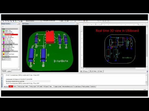

    The electronics workbench package from NI, contains a program called utiliboard, which lets you design parts in 3d and render the board result.
    I have used it and its one of my favorite schematic/pcb design programs, but the suite is expensive, my copy came from tech school.
    I haven't found any other program that can turn a schematic into a 3d render with such ease.
