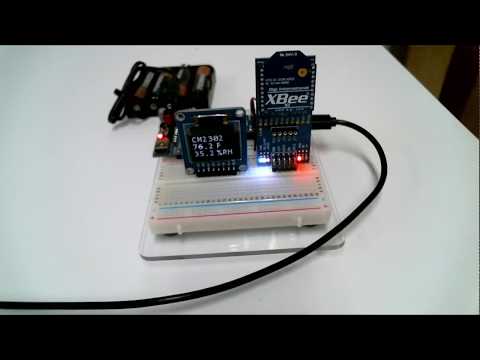

    Also, I notice that you are using XBee modules to send and receive data. This becomes a lot of fun!
