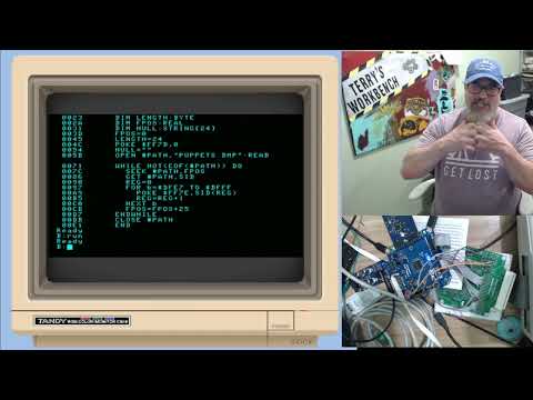

  • ke4pjwke4pjw Posts: 1,324
    edited 2025-07-08 04:22
    @pik33 Interesting. The project I am using it in, called the CoCo Blender, it would be advantageous to use LUT rather than Hub ram. The project is a retro computing project for the Tandy Color Computer. I emulate a serial port connected to a modem layer that can connect to other systems using AT commands, a real time clock that is actually just the P2 seconds counter, that gets updated twice a day via NTP, and SID cog. Lot's of hub ram access going on there and anything I can do to pull that back, is good.
    Here is a video of the project so far. The OS I am running on the CoCo is called NitrOS-9 and is a multi-tasking OS. (Based on Microware's OS-9)
