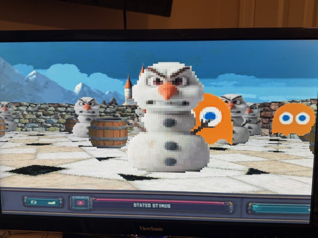

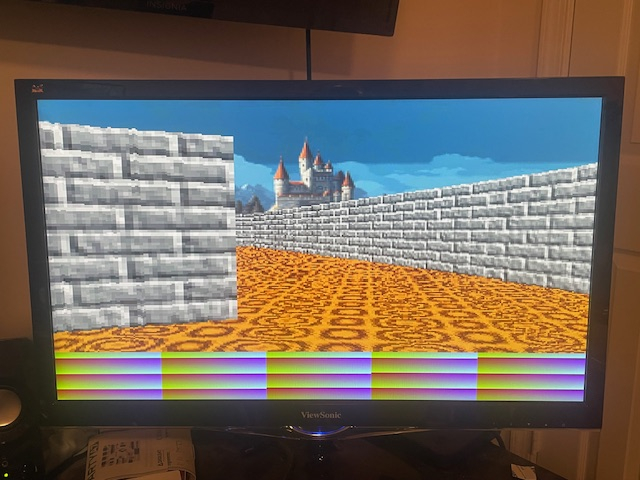

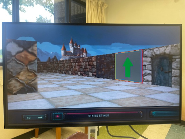

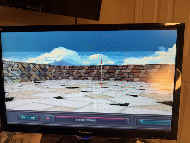

See attached pic.
Update: Now working on P2 Eval. Source code posted here.
Getting ~37 fps using just one cog on 250 MHz P2 Eval.
But, speed can be dramatically improved (by using more cogs).
Features background, textured walls and textured floor.
Far away walls now a bit darker.
You can see where I got this idea from here: https://permadi.com/tutorial/raycast/demo/5/
I've made some notes on the coordinate system, attached here for reference.
Update: Rev. Main3b now uses USB keyboard scancodes for movement

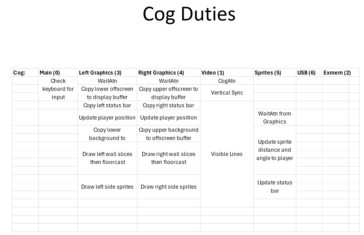

Update2: Rev.4b has 60Hz synced updates to be tear free (now using 2 cogs for graphics).

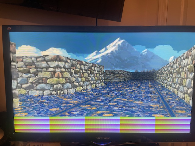

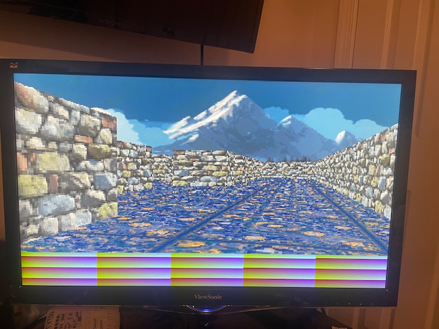

Update3: End of thread now has graphics at 16bpp and using PSRAM for background, WIP

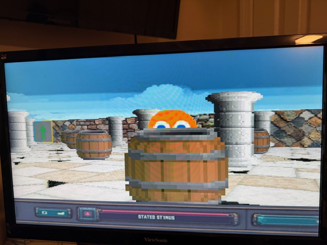

Definitely prettier!

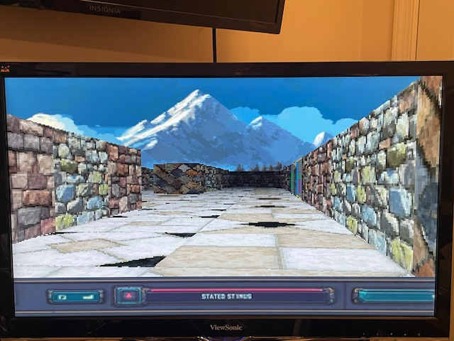

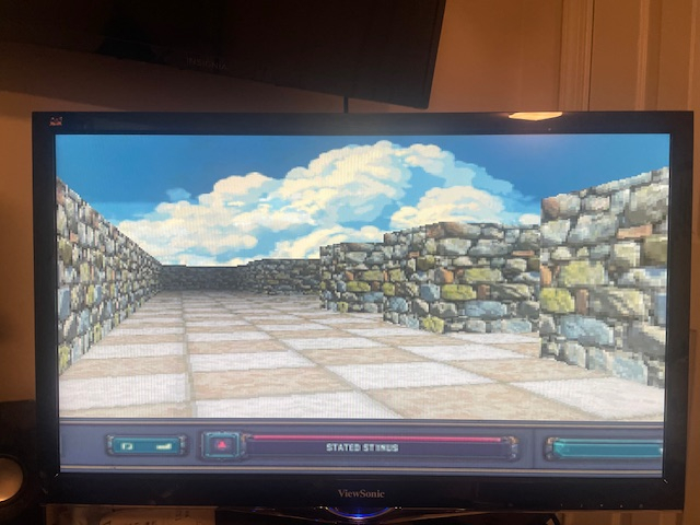

Update4: Think have sprite logic working. Exploring what is possible at 30 fps...
Update5: Now playable! See post #201 here for latest files...

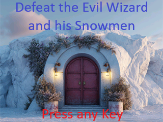

Update6: Added simplesound.spin2 to have music (and sound effects later) see post #208

  • RaymanRayman Posts: 16,456
    Actually, I ported first to MFC C++ and then to P2ASM...
    Windows test exe attached. It's very slow, but you can move with WASD
    The frame rate can be dramatically improved. I haven't made any attempts to speed it up yet, just fixing some bugs...
    The floor is what's really making it slow. Background too. Wall drawing is super fast.
    But the author has this note on drawing the floor:
    FLOOR CASTING at the simplest!  Try to find ways to optimize this, you can do it!
    So, I think it can be improved...
    It's done!
    Well, at least it's fully operational.
    Now, need to work on speed and precision...
    Download the binary from the first post to try it out.
    One thing I haven't totally figured out is how to do shading like the JavaScript source.
    They are working in 24-bit color mode, so it's easy.
    But, in 8-bit mode, it's more of a challenge.
    I was able to make 2 additional copies of the brick wall, each a bit darker. This works OK.
    For a real game though, you are probably going to want several different wall bitmaps and then memory usage might become a problem.
    I'm toying with the idea of using tricks with the palette to do this instead.
    But, the palette is limited too...
  • Do 3-3-2 color encoding, 8 shades of red, 8 of green, 4 of blue
    Interesting idea... I just looked into it.
    Problem is that there are only 2 shades of gray.
    Won't work for this gray wall very well..
