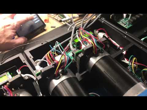

    One Prop on the LCD gets status from all three Prop controllers and then sends commands to to move as needed. Rs485.

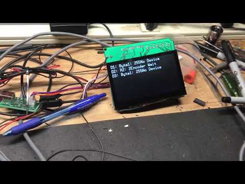

  • Testing boot up of 3 Prop systems that will be sequences from the master LCD Prop controller.
  • Very cool. Hopefully, you'll post a vid when the motors are all bolted up and moving the axes.
    So one Prop/axis and linked via RS485. I am also doing this and the reason being is that I have had enough of wading through rats nests of wiring. I intend to locate my "motion modules" as close to the motors as possible and do something similar with the "I/O modules".

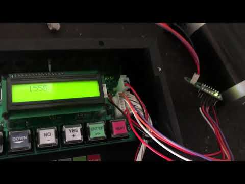

    The Click is interesting. Someone already posted a SPIN object for the LS7366r. It works right away. They are using a SSN/CS line toggling high low before every command, I will try to see if that is really needed. I need to find someone I can pay to make a PASM version. I might miss having the encoder pins show up on the prop which is sometimes helpful on a diagnostics screen that shows all inputs. In case of problems it’s nice to look directly at the state of each encoder output. What I may do is just leave the main board alone as the encoder lines already have some termination with 100ohm and .01 cap that helps with noise on the typical 25’ unsheilded cables. Then jumper the Click board in to the same encoder inputsbonnthe Prop and run the click off the battery/5v reg. The motor has a BOB which gives 5v to the hall sensors and to the encoder. It cannot be separated at the main board side. The would mean I’d have to send the 5v to the motor from the battery over the came cat5 cable (cut traces on the main board and insert +/- battery lines instead of board 5v. Then the 3 hall sensors and the encoders will always have power. This is not a big deal probably just a few more devices to keep powered.
    Edit. It seems that you must toggle SSN high low to start each counter read. This means 4 wires required. The good thing is on power up you just read the count. No other commands required.
