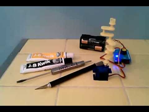

  • ercoerco Posts: 20,259
    I usually do things by brute force, ignorance & experimentation. Here I align a homemade "coupler" made of JB Weld (AKA epoxy) and test the alignment while the epoxy sets up. Definitely use quick-set epoxy here!
