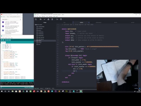

    And now there are the TinyFPGA BX boards. https://tinyfpga.com/
    Here is Robert Baruch unboxing one and showing how quick and easy it is to get going with the open source toolchain.
