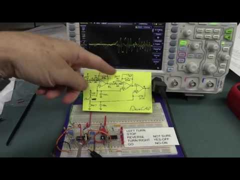

    But it just HAS to be better than the VCP200 voice recognition chips I got from Radio Shack back in the 1988: https://www.ebay.com/itm/Radio-Shack-Archer-276-1308-Voice-Recognition-IC-VCP200-Tandy-NOS-Vintage-1988/282976262537
    Speaker independent, and VERY few commands. Your choice of:
    1) Yes/No or On/Off Just two choices, more reliable than...
    2) Go, Stop, Left Turn, Turn right, Reverse
    They do work, but you need to practice saying the words in a way the chip likes. Watch EEVblog Dave test it at 19:00:
