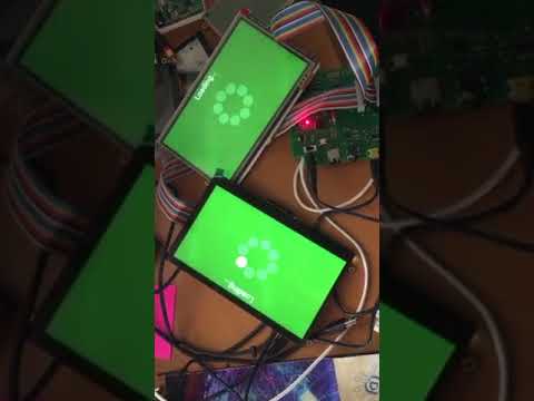

    With some quick changes, can now control two 7" LCDs from one SPI bus.
    Getting really close to being done now...

    I'm making a box with 4 touchscreens… Two 7", one 4.3" and one 3.5".
    Box will control two High Voltage Power Supplies. The 7" screens will show details for each supply. 4.3" will show overview. 3.5" will have some buttons (TBD).
    Going to have two SPI busses with 2 screens on each...

  • How are you using the same SPI bus for multiple EVE2. Are they ID’d?
  • RaymanRayman Posts: 16,199
    edited 2018-07-04 17:17
    Currently, each display has it's own chip select and power down pins.
    They have interrupt pins too, but I'm not using them because polling looks to be just fine...
    It's the individual CS pins that lets them share the SPI bus.
    I could actually put all 4 displays on one SPI bus...
    LVDS? Maybe when Prop2 comes out...

    I'm not clear here - The picture appears to show one board, and 2 ribbon cables (parallel RGB ?) to LCDs , or are there 2 x EVE2s on that board ?
    Is this one EVE2 per display, or can you work 2 displays from one EVE2 ?
  • An EVE2 is built on the back of each LCD.

    Think I have it now :) This version demonstrates controls on two independent screens on a single SPI bus.
    I've also made it so that image upload can go to both screens at the same time.
    Want to make it fast to get a splash screen on both screens...

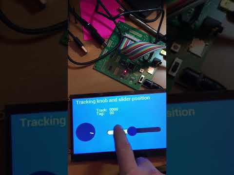

    Playing around with some EVE2 extras...
    Sound is pretty easy to make work.
    I spent some time trying to make mpeg video work, following the example software provided...
    It appears that it's not as easy as I hoped... First, I looked at their demo video again and I think there is actually no sound. Also, their sample code does not use the "PlayVideo" command. I have a feeling that that command does not actually work. Appears that on the PC side they are parsing the .avi video and extracting the video part and then sending that to the media fifo. Code is a bit hard for me to follow, but appears they just use the "LoadImage" function with the use "MediaFifo" option.
    I used handbrake to transcode the same video they used into mpeg2 video, but could not get that to work. They have the advantage of a .avi parser on the PC side to help extract just the video portion, I think.
    I don't actually need video, so I don't think I'll pursue this much more. But, the attached loads a jpg image into the Media Fifo and then uncompresses and shows it. It's a little different than last time only that the jpg data is first loaded into main memory (in an area designated to me the media fifo) before decompression. Before, I just sent the image data to the command buffer. The command buffer is only 4 kB, but I was probably sending the data slow enough that it didn't overflow.
    Looks like we can store several jpg or png images in main memory, call that area a mediafifo and then decompress to show. This can actually be useful, since I'm just on SPI and not QPI bus. So, can store all the images I need in GRAM until needed. This 7" screen has 800x480 resolution so it needs 750 kB of GRAM for the uncompressed image. But, my example jpg image is just 36 kB and looks OK. GRAM is 1 MB, so there is still ~250 kB left for images, so several full screen resolution jpg images can fit there...

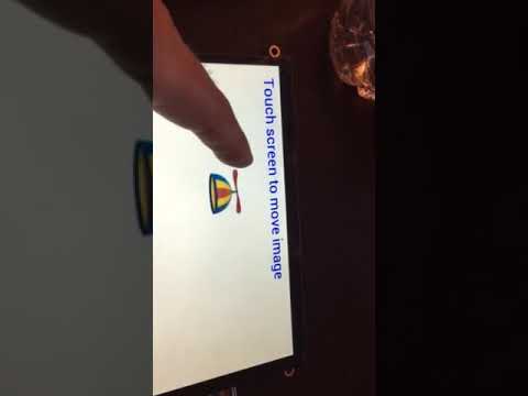

    Here's a test of bitmap overlay with transparency, rotation and scaling.
    This actually worked out as good as I hoped.
    See below for a png image with transparency (alpha channel) that was small enough to be embedded in code.
    It is drawn on top of a full screen jpg image that is pulled from micro-SD card and loaded to EVE main memory.
    I think this rotation and scaling opens up some very nice possibilities...
    Here's a video:
    code is posted below..
