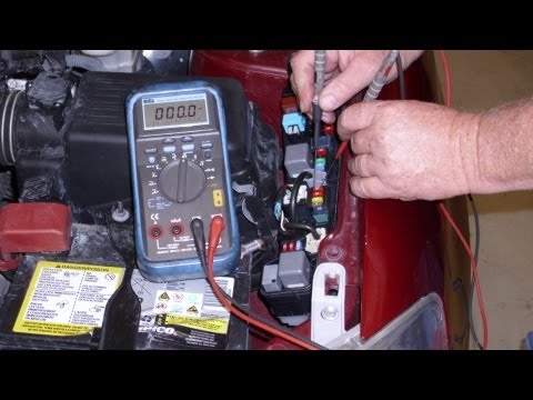

    If you read the thread, then you will know that I know how to test for total current draw and I also know how to pull the fuses and test for current draw across the terminals for the individual circuits.
    Even if you had a device that you are talking about you still need to pull the fuse to attach leads.
    Or insert some fuse bus extender either way the fuse still has to come out. Unless your talking about old cars with glass buss fuses. Any later vehicles have plug in plastic fuses I don't see how you would get test leads in there.
    Not true. Read the thread or watch this video
