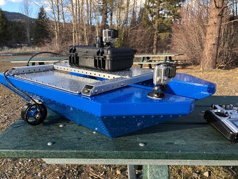

  • Ken, I would like to know how the pontoons were built.
  • JDJD Posts: 570
    Nice looking boat Ken. The more information scientist and environmentalist have on the lake, the better they can understand what is going on and offer suggestions to keep it blue. CO2 and other greenhouse gases would be cool too I think.
    edited 2018-02-16 02:14
    lardom wrote: »
    http://www.manifoldrobotics.com/
    They're welded 6061 aluminum (.060"), sheered and break for max strength with built-in pem nuts for the top plates. It's a super nicely-designed system. I ran into Jeffery Laut (the creator) a few years back at a course we were running in NYU (Brooklyn) and watched him go through several revisions before we purchased.

  • The product already comes with ArduPilot and can be setup with missions guided by GPS.
    It would be simpler to interface the Propeller to the ArduPilot as this is easily done as a companion computer.
    It could then be told to move to a position on the lake and then take the samples. Then the propeller could tell the ArduPilot to go to the next waypoint and take another sample and so on.
    I have already done something like this and it works great.
    ArduPilot does all the heavy lifting that it was designed to do and you just tell it where to go.

    Yes, I'm aware there is an easier way to do this. I'd like the series of steps to be demonstrated in BlocklyProp in a way that people could understand them. ArduPilot is an effective tool, but it's also a black box to our customers. I want them to look inside and understand a fully-documented, but simple system (if it's possible).
    We'll see what happens when I actually get into this effort. I've got a number of helpers on this forum including Phil Pilgrim, who is attempting the same project with Spin up in Port Townsend. We will likely connect this summer in a friendly competition to test out our efforts.
