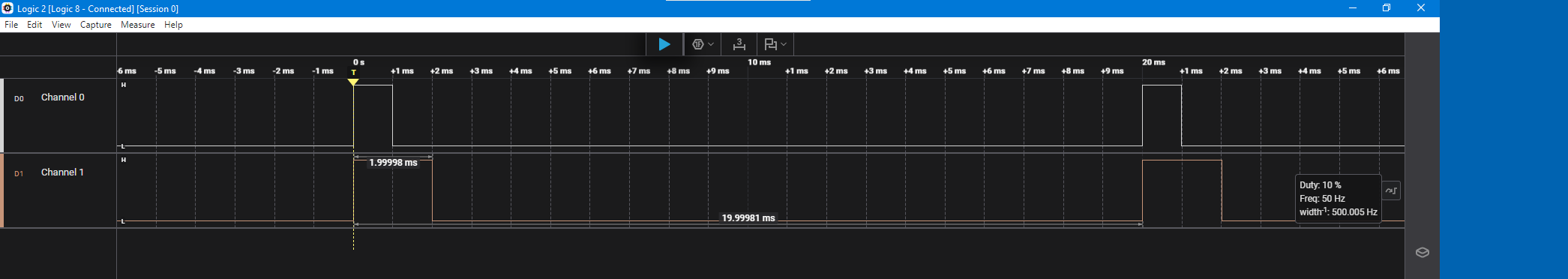

    If you're only needing to control two servos -- and you have cog to spare -- you can easily do that in Spin (or any other P1 language). The CTRx module (in every cog) has two counters which will let your run two servos (without reconfiguring), and you get nice precision with your pulses (1us in this simple code). I've attached an easy, 2-servo object. it uses the PWM/NCO mode of the counter to create the servo pulses. The code as is lets you set the position in microseconds, but with the resolution of the system counter you could do sub-microsecond (e.g., 0.1) pulses if you like.
    Here's quick check of the object output setting servo channel 0 to 1000us and servo channel 1 to 2000us.
