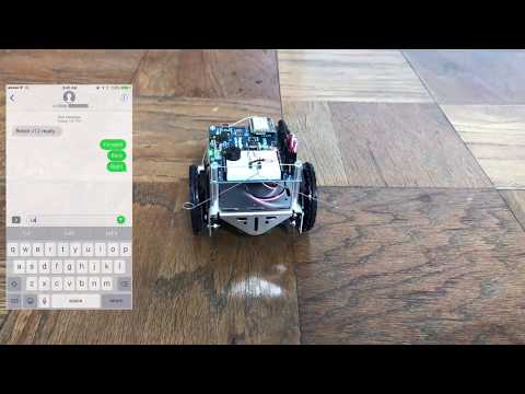

    There's also this:
    It was coded in BlocklyProp and I'll get the links for us from Rob Faludi (Digi).
  • Thanks, this kind of support for always on, Internet over cellular was exactly what I was hoping for.
  • Ken Gracey wrote: »
    There's also this:
    Nice! You finally got a taker for the BlockProp code with the XBee Cellular. Looks very cool.
