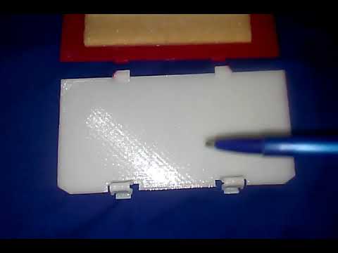

    Sorry, this little project got lost in the holiday shuffle. Just got the door from my friend today and it definitely needs some tweaks. My part was printed on a Mojo printer in beautiful white ABS. I don't think a PLA door would work nearly as well. Long story short: clips are perfect. Tabs each need a chamfer. Overall length & width too big, reduce each by 1 mm. First photo shows a "wedgie" with the too-wide door wedged in. Video walkthrough follows. Ken or Stephanie, happy to send you this part if you like.

    Anyway, I measure the length at 111.90 mm and width at about 56.30 mm. Thickness is 2 mm.

    Printed with Formlabs Form2 SLA printer (just for fun, I don't actually have a scribbler).
    Came out looking great! Measure 112.0 mm for the length and 56.5 mm for width, so should be perfect fit.
    The latches seem springy enough to work.
    Anybody want to try it?

    Steph said it was a hair too big!
    We're ~ 1 mm too big in both dimensions... Sounds like it broke when forcing it in...
    She measured the actual door and it's ~1/2 mm smaller than the STL file says...
    But, I've made some new ones to try. This time scaled to 99%.
    There are two clear ones. One is just scaled, the other has some extra thickness added to the bent part of the hinge, where it seems to break.
    The gray ones are printed with Makerbot with "Tough PLA" at a 90 degree angle. I was surprised it worked at 90 degrees, but this should make the hinge very tough to break.
    The black one is printed in Nylon at 20 degree angle. Nylon is super strong. I don't think it can break, but it's a bit warped and the hinges aren't perfect.
    I'm trying the black one again with rinse away support material to see if that makes it better...
    Anyway, I'll mail these to Steph and hope one of them works without breaking...

    It took a few tries, but I think we found a version that works!
    Steph said the last ones I sent her worked and passed drop test when some foam was added to keep batteries from rattling around.
    I printed the attached .stl file with a Makerbot Replicator using their ToughPLA and matching extruder.
    One special thing I did was to print vertically (with supports). Was a little surprised this actually worked, but it makes it extra strong.
    See attached photo to see what I mean.
    You need to print at 99% scale for some reason to make it fit right.
    See attached image for how I added some extra material in the hinge (green) to make it a bit stronger.
