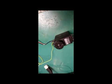

Is it normal for the servo to be shaking like this while waiting for command in terminal? I simply connected the servo to project board & run it with the C code from the website. I only changed the pins assignment.
int pinFeedback = 23; // P14 connected to feedback line
int pinControl = 25; // P12 connected to control line

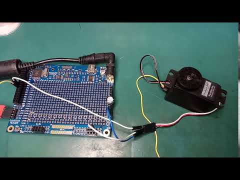

  • Thanks, guys.
    Initially, I powered my PPB USB with a 7.5v since manual wrote > 5v. However, after I changed to 5v, the oscillation stopped.
    Next, I've updated the workspace according to Andy's suggestion. It seems to have eliminated the most of the shaking after reaching the designated angle.

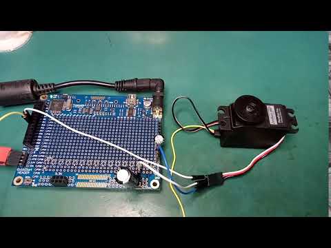

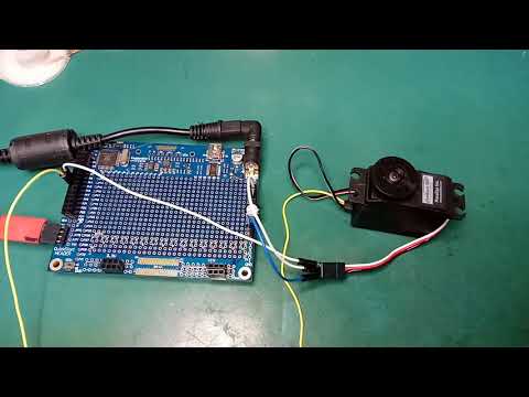

    This is back to 7.5v
    Same after adding the cap.
    I'll eventually return to SPIN/PASM so I'll try Tom's link.
    Thanks again!
