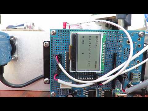

Yeah, it's not something I'm selling or even letting anyone else use.
You would think common sense would prevail, but sooner or later someone will come along that won't understand how it works or how it's triggered and it could end badly.
Once I get the auto loader set up you won't have access to the crushing area.
Not even sure that will the auto loader will work out as every twenty or so cycles a can will get crushed in a weird way and jam it it up. That will be a pain to clear as you will need to gain access to the crush area. So, I may add additional beam interrupters and detect if an obstacle (ie... someone's hand) and stop the process.
But as it stands right now, it's about as safe as running a chainsaw on the top rung of a ladder.

As background I've actually built a can-crushed using a motor, gears and a M8 rod as a leadscrew. I designed
it for 2000N max force, based on estimating the weight a can can hold up when you carefully step on it!
2000N is not always enough at low speed, but at full speed of my crusher its pretty reliable.
The safety issue is similar, but it takes about 3 to 4 seconds to operate which is less scary without
any guard - however releasing requires the motor to be reversed and the gearing makes that slow
by hand!
When complete it will have sliding doors like a lift and an interlock on the doors. The plan was to play
suitable audio clips during the crushing with an mp3 module to make it fun to use.
