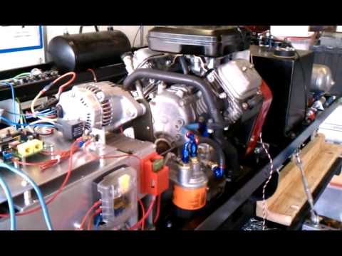

The basic idea for the project was to operate a 1/8th scale train using all computer control. I started the project using the BS2 but soon wished I had gone with something more powerful. The result is that I have spent a good deal of time optimizing things so my CPU has the time to do everything I want. That's probably and ultimately a good thing.
The drive system for the train uses a 16hp gas motor that turns a 10kw alternator. Alternators are interesting because they generate no AC at low RPM. Therefore, I automatically have a transmission. Idle the engine and I sit still. Increase the RPM (throttle) and at about 30 volts AC I start getting some power. From then on, I just rev up the engine and I get more AC Volts and Power.
I take this voltage and feed it into a large bridge rectifier and I get DC that operates two surplus treadmill motors.
By selecting a good gear ratio, I have a pretty nice running motor control.
My alternator has two 120 volt outputs. I actually have two locomotives (A Unit and B Unit) so I can hook them together for more pulling power. Half the alternator feeds one, half the other.
Most of the time, I just run one Locomotive.
The first time I ran the engine, I used two hobby servos and a regular model airplane controller to run the train. One servo hooked to the throttle and one to the choke. After I ironed out the mechanics, etc. I started on my Stamp Control Portion.
My train also has classic Westinghouse Air Brakes. This is a long complicated topic but basically, you charge up a tank with air. The air pressure from the tank turns on the brakes. You turn OFF the brakes by maintaining the airpressure to the system. When you start lowering the air pressure, the differential between air in the tank and the control pressure, gives you a proportional control to the brakes themselves.
Pressure up, brakes off. Pressure down, brakes on. That way if the airline opens or cars separate, brakes automatically go on.

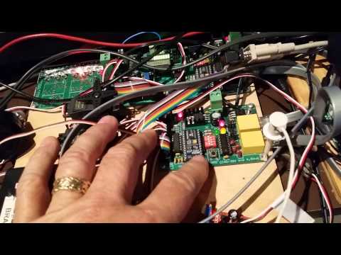

I am running 38.4k N,8,0 for all my serial commands. I am also using a variety of Stamp modules. BS2 for the simple things and BS2SX on some of the others.
There is a board with an SX on the engine that uses SERIN to receive the serial commands and convert them to useful things on the train. I am using the ServoPal to talk to the two hobby servos for Throttle and Choke. The rest of the stuff is using the 74C595 output shift registers that I learned to use on my first Stamp project in Stampworks almost 15 years ago.
I have 16 relay channels that I use for various things including headlights, starter, etc.
The control function just goes as fast as it can, timing is basically how long does the SERIN and SEROUT takes. I have a couple of LEDs on both the REMOTE and CONTROL boards that I TOGGLE during the cycle.
The Air Brakes operate with the PWM command into a little RC to create a DAC. I found a voltage controlled air regulator that takes 0-5 volts in and adjusts my brake air pressure from 0-100 PSI On board the Locomotive is a small air compressor used for Air Shocks.

There is a separate Basic Stamp on the Loco that has two ADC0838 ADCs so I can sample 16 Analog Voltages. I also have a few digital inputs.
I use COUNT to sample a pulse from the wheels to give me MPH and another COUNT input to show me engine RPM. Most all the other inputs are analog.
All this data is sent back to my system over SEROUT with 20 bytes of data.
